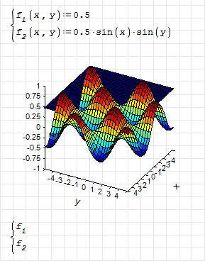

am I wrong or the x and y axis are exchanged?
I have downloaded smath studio a few days ago and made some examples to be more familiar with the program. Today I have tested 3D plot and found 2 strange behaviour.
First on 3D plot x and y seems to be swapped
Second the same formula plotted by 3D plot and by 3D graph give a different view
#23 Опубликовано: 08.04.2014 08:59:12
The SMath built-in 3D plot is left-handed, the 3DPlot Region is right-handed (being able to choose, I prefer the 2nd but is matter of taste)

fdufnews
fdufnews
Thanks for answering.
But the sin function is defined with y as variable and the step function is defined with x as variable. On the 3D plot the sin is along the X axis and the step function along the Y one.

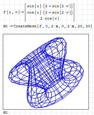

#27 Опубликовано: 28.12.2018 17:20:33
Updated.
Changes:
- CreateMesh(): (u,v) can be skipped for the function;
- 3D Plot Region: began updating the code (draft version).
#28 Опубликовано: 28.12.2018 17:36:11
About 3D Plot. Unfortunately, the source code that I found requires significant improvement in order to display a family of graphs. I hope I have enough time and desire to bring this component to normal at last.

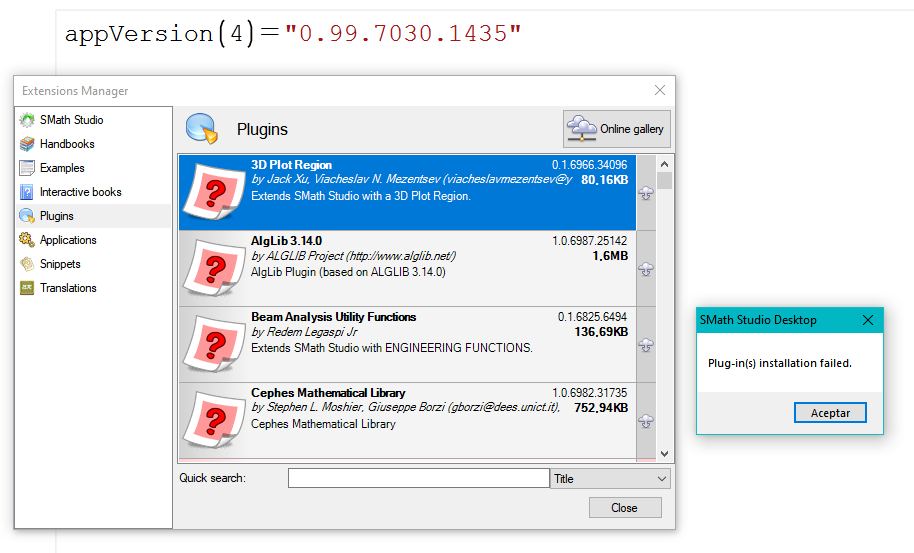

I really need this amazing plug-in to plot around a million independent points, but I am having this issue with the installation. Could someone help me?
Thank you in advance.

Unfortunately, I cannot build a project on the server. We will wait for an answer from the author of the program. As for the plugin itself, it is not yet complete. Displaying data is not intuitive.

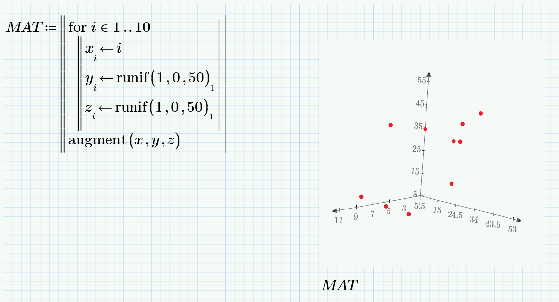

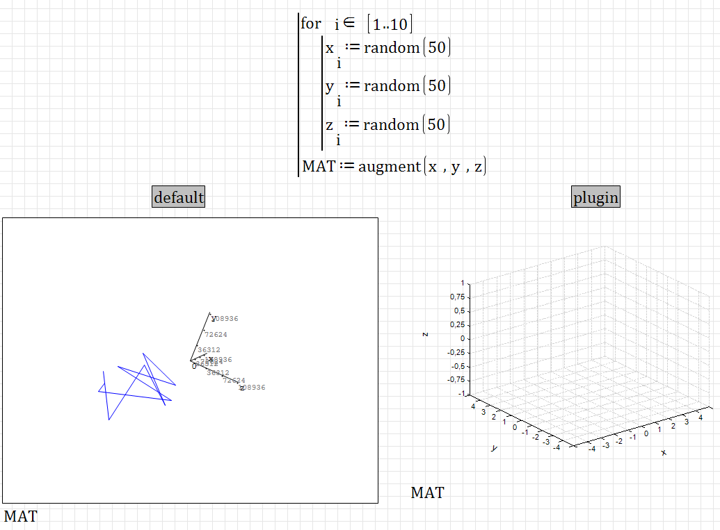

Thank you uni and Jean for your answers, now I reviewed my problem. Fortunately I have already installed the 3D Plot Region plugin (99.7030 SM version). I don't know why "plug-in installation failed" last week, but now that problem is solved.
What I understand for the 3D plot region is that you need a function to be plotted, and please correct me if I am wrong. I was reviewing your image creation files Jean, and was very helpful for me to know those functionalities, but in my case, I have a 3D graph more like "scatter plot".
Here, for example, I generate a random matrix 10x3 of ten points in x,y,z coordinates. In the included default 3D plot, it seems that I cannot delete the line between points (I want only the points to be displayed), and also I cannot extend the axis coordinates to verify the coordinates for a point. It looks like the coordinates are reversed, since there is no point plotted in the x+,y+,z+ region (and that region should be the only one with plotted points). Also it seems to be totally out of range because my axis values are around 50000 and I have values no greater than 50.
I hope you can help me, or if you know that I could do this sort of plots in another program but from SMath (I begin to know about Maxima, for instance).
Thank you both again!
SMath:
Mathcad:
SMath file:
Scatter plot.sm (4,54 КиБ) скачан 1535 раз(а).
(sorry for the too large images, I don't know how to change that)
#36 Опубликовано: 10.05.2020 19:31:15
Now this component cannot be fully used for your purposes. Point visualization is not implemented. I am still looking for time to study the theory of three-dimensional graphics. Unfortunately, the limitations do not allow the use of free components. Writing everything from scratch is a time consuming task.
