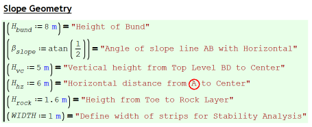

A small text correction to my post #1.
Sorry for inconvenience please.
Point A and Toe are also same.

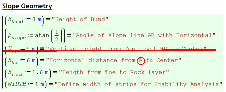

Second correction, as the variable Hvc is no longer used in the entire program. Please delete the entire line as indicated.
Extremely sorry.
