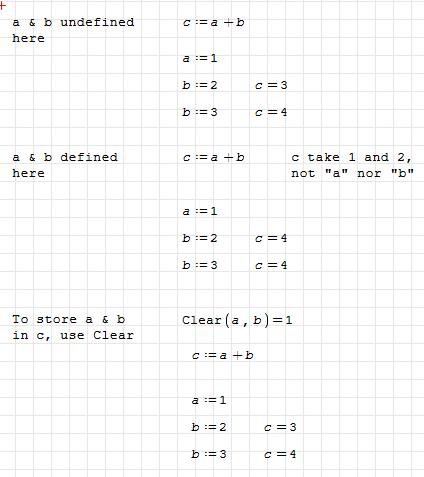

In the image below, I redefine b after using it in the calculation for c on the third line, but when I try to recalculate c on the 5th line, it doesn't use the updated value for b. I have to redefine c for the variable b to use the new value for b.

Hi Bertrand. Try this, please.
