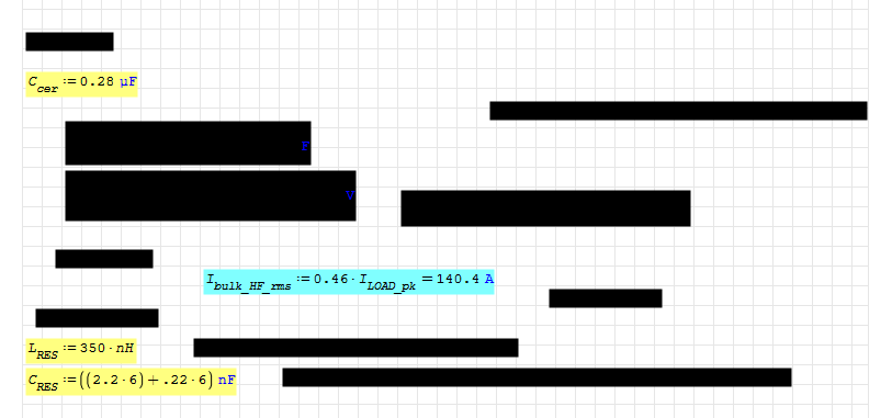

I'm working on the same file at home and at work. Today when I loaded it at work some lines' background turned black. This is version "0.99.7219.26345"

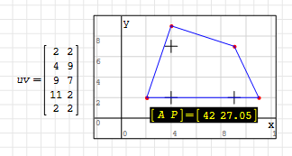

... download this recently created SS 6179.
What do you get in your recent SS 7219, all black ?
Maths Polygon Area_Perimeter.sm (55,37 КиБ) скачан 1394 раз(а).

Yes, because I created this way [yellow maths on black background].
BTW: black is not [0,0,0] rather [1,1,1].

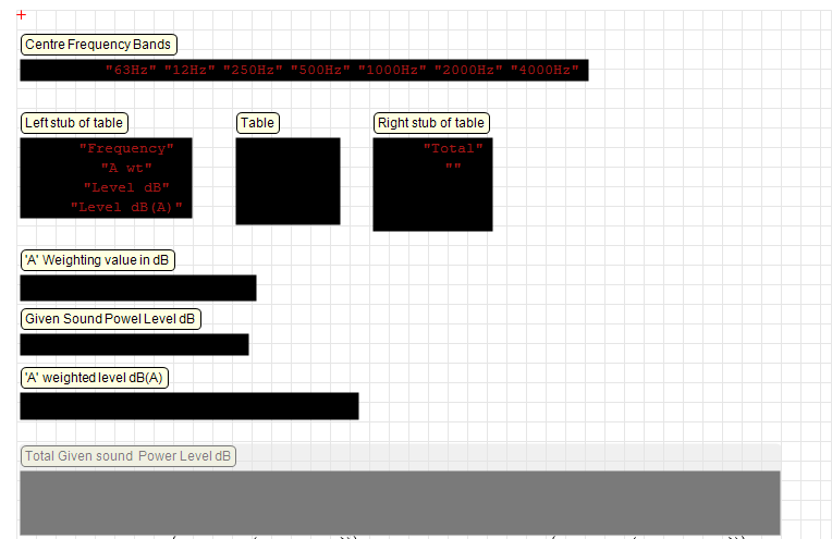

I have the same issue (0.99.7251.32800) with the acoustic file on https://en.smath.com/forum/yaf_postsm59725_Summation-of-log-functions.aspx#post59725

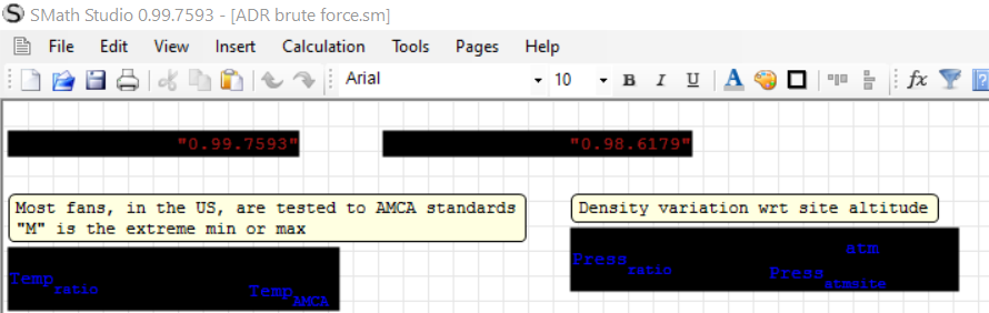

Bug is still present in Jean's file. Funny thing is this was MY work. His items came were hit or miss. I'm working off of portable version. See file post #3
