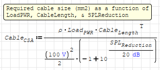

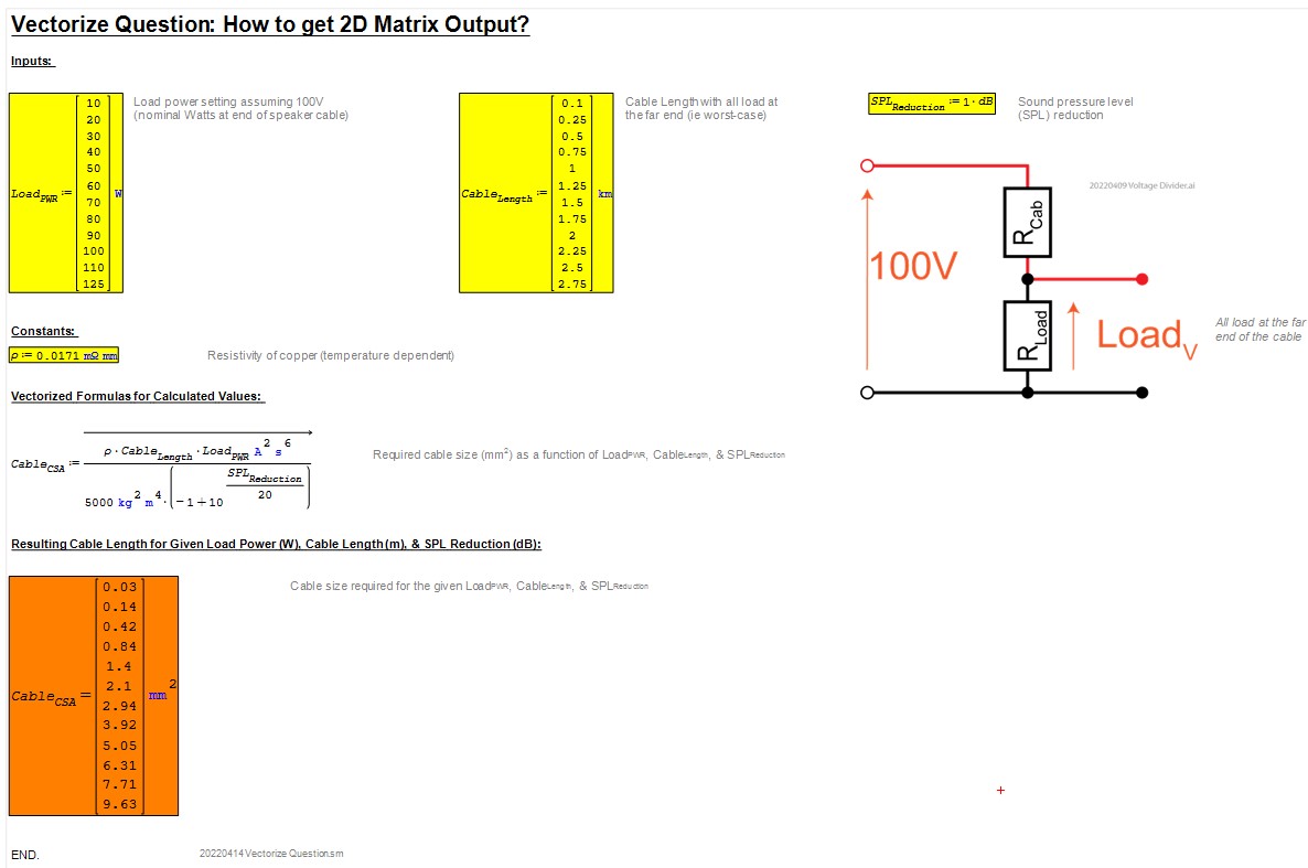

I've another noobie question. I'm hoping to get a 2D matrix/table output for two 1D vector inputs.
20220414 Vectorize Question.sm (52,61 КиБ) скачан 1184 раз(а).
How can this be best done?

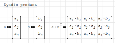

#2 Опубликовано: 14.04.2022 05:36:58
It can be done by dyadic product or piecewise algorithm calculation.
Notice the transpose symbol in your formula. Needed if both vectors are vertical or horizontal.
I have included both calculations, disabled algorithm calculation in collapsed area.

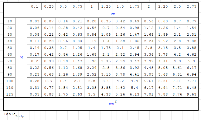

And since you asked, I have formatted the output with table region.
Check the file and pictures below.
Edit: I screwed up the product and table, corrected it now.
20220414 Vectorize Question_answer.sm (89,8 КиБ) скачан 1254 раз(а).

Thank you so much overlord.
BTW: did you spot my evil(ish) dB:=1 declaration? (no SI units were harmed).
#4 Опубликовано: 14.04.2022 05:55:13
I did and I didn't bother to correct it.
If you won't propagate "units are evil" I won't object it.
It is your choice. I have corrected the calculation.

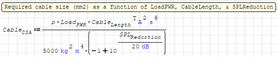

It could be done by this way though, with using SI units.

#5 Опубликовано: 14.04.2022 06:09:48
Mark R Harris
Mark R Harris
4 сообщений из 90 понравились пользователям.
I certainly am wanting to stick to SI units for all the good reasons.
I will work through this to understand it better. My memory of this is that dB really is unitless, so the 'dB' is likely just a placeholder rather than something referencing the base mks units. I'm keen to know if this assumption I've had for a few decades is incorrect.
#6 Опубликовано: 14.04.2022 06:13:39
Yeap, dB is unitless. Use what you want.
But embedded units are better to stick with.
Actually, your formula can be reduced to this.
Power of SI units. (swh)
Mark R Harris 14.04.2022 06:15:00
#7 Опубликовано: 14.04.2022 06:27:52
Mark R Harris
Mark R Harris
I'm liking the consistent description position too, thank you. Much better than free floating text.

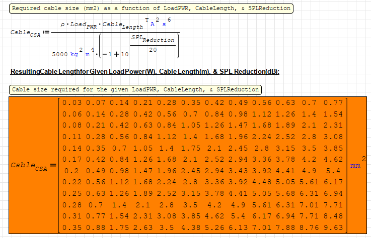

#8 Опубликовано: 14.04.2022 09:37:49
Your sample assumes 100V input according to picture.
For that, number of 5000 bothered me and maybe my assumption is wrong.
Is this a possible correct formula with voltage input added?
100V can be changed with a variable by this way.
#9 Опубликовано: 14.04.2022 16:33:31
Mark R Harris
Mark R Harris
At this point, if you have such standard table ... validate.
From standard table, easy to interpolate.
Thanks Jean,
An important topic on its own: validation and review. So central to good engineering & metrology. Already done too.
One of the reasons I like SMath is measurement units. The continuous units consistency checking is great.
Without it (units ignored or overridden), it is possible to get the correct (or close to it) numeric answer and be fooled.
Yes, 100V is the standard distribution level pretty much everywhere outside the US of A.
There it is 70V.
It should indeed be variable or constant.

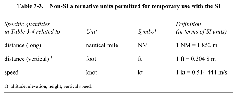

I understand nautical knot
The world standard for aircraft speed is SI units:
with knots operating on a 'temporary' exemption.
Two units with the same name, but different meanings are being used by people that need to work together. Ditto for different units for the same thing (height, wind speed, pressure, fuel mass, COG mass calcs, etc). What could possibly go wrong?

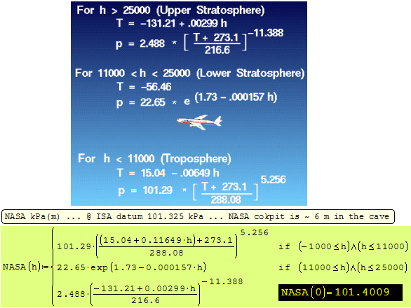

#14 Опубликовано: 18.04.2022 08:25:51
... What could possibly go wrong ? More, like cockpit calibration.
#15 Опубликовано: 18.04.2022 10:19:56
If you don't know units, how to use them, don't have the capability to understand its importance, even you oppose using units, just as like Jean, everything can go wrong.
And yours is another milestone example of that idiocracy.
#16 Опубликовано: 18.04.2022 13:22:45
Most. To begin it is a wrong sign in "15.04+0.11649*h", so it should be "15.04-0.11649*h"
In addition, this resource is not for technical use, it is for "K-12", which in the USA means that it is for elementary and high school children. The image page can be found here:
https://www.grc.nasa.gov/www/k-12/airplane/atmosmet.html
At the bottom in the complete image it can be seen how the author does not care in the least to follow the SI standards of units, using notations as varied and meaningless as "K-Pa" and "cu m"
