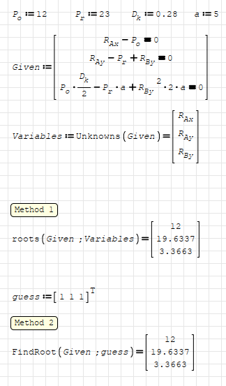

I would like to solve a system of linear equations in Smath Solver as in Mathcad. Is it possible?
https://ibb.co/WgwntqW

I'm already browsing Solve Grand TREASURY. I am sending missing data in the file.
Reakcje.sm (3,74 КиБ) скачан 1154 раз(а).
Sorry, I don't know how to put the matrix at the end.
Reakcje.sm (7,59 КиБ) скачан 1139 раз(а).
https://ibb.co/ctpTZ7q
