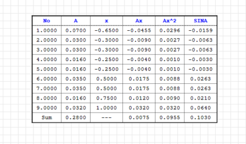

Something like this?
Tabla_Momentos.sm (57,1 КиБ) скачан 1117 раз(а).
Carlos
Carlos
Exactly what I was looking for! Thank you so much! This function is going to be really useful for me.

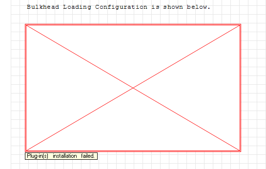

Hi Carlos:
This happened while I was working on it.
This red cross took all of the work after the plug-in away.
Have you experienced this?
How can I fix it?
Thank you!
Chris

Hi Carlos:
How can I fix it?
Thank you!
Chris
Hi Chris
Yes, I've had that kind of problem, and it happens when the Plugin is not recognized or is not installed.
You have to install the plugin or update it.
Verify that your version of Smath Studio is compatible with the version of the Table Region Plugin.
Carlos

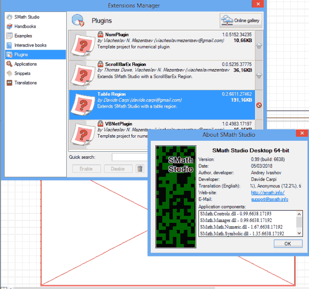

Hi Carlos:
Thank you so much for the response.
How do I know if they are compatible?
I installed the plugin from within the extension manager (from online gallery) and assume they are compatible?
Thanks,
Chris

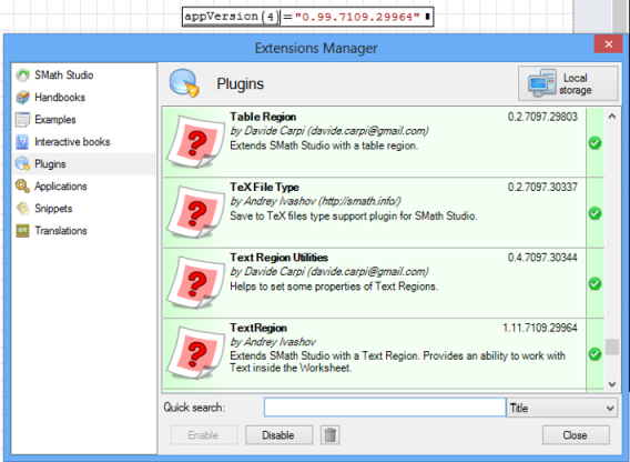

#11 Опубликовано: 02.07.2019 19:05:37
Seems the right version. You can guess it is the right version by the 3rd 4-digits number, that should be similar and usually the same or slightly greater in the plugin. You can have more hints by checking the release dates. If you installed it by the internal release manager or by opening a worksheet there shouldn't be conflicts. I don't know what happened, if I have time tomorrow I'll try to make some tests...
#12 Опубликовано: 02.07.2019 19:09:04
CBG
CBG
Hi Chris
The green color and the tilde indicate that it is compatible.
When the plugin is not compactible it is shown as the following example.
Why not try the latest version of Smath Studio?
Carlos

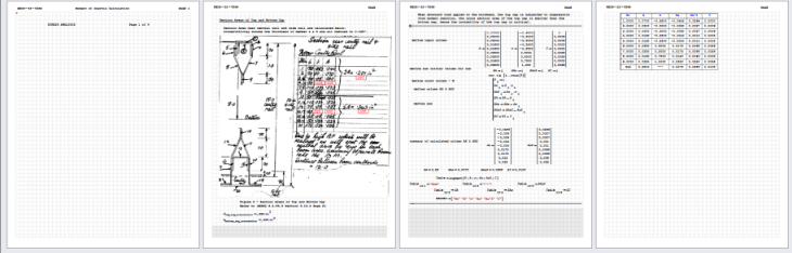

Attached is the subjected worksheet. Please review.
Thanks again!
Chris
Hi Chris, I have downloaded and opened your file, same problem on my PC.
In any case, Table plug-in is still working correctly for me, when opening other files.
So, I'm afraid that in your case the bug is not in the plug-in installation itself, but in the calculation file that maybe got corrupted in some way?
Strange that when I open you file, first page is completely blank, second is a snapshot of a figure/book, third apparently contains nothing more than one declaration, some text and the mentioned error "red box".
Is there no other maths? Or did it get deleted by you? Or maybe by the bugged table?

Hi Fedeghi:
Thank you so much for trying to help.
I deleted the first page. When the "red box" appeared, it took about 4 pages of content away. Only 2 pages are related to the table region, the rest of them were independent.
Stress Analysis-Moment of Inertia Calculation.sm (27,27 КиБ) скачан 1049 раз(а).
Here is the "table region" as an independent file. It worked fine until I inserted it into the main file.
Thank you!
Chris
