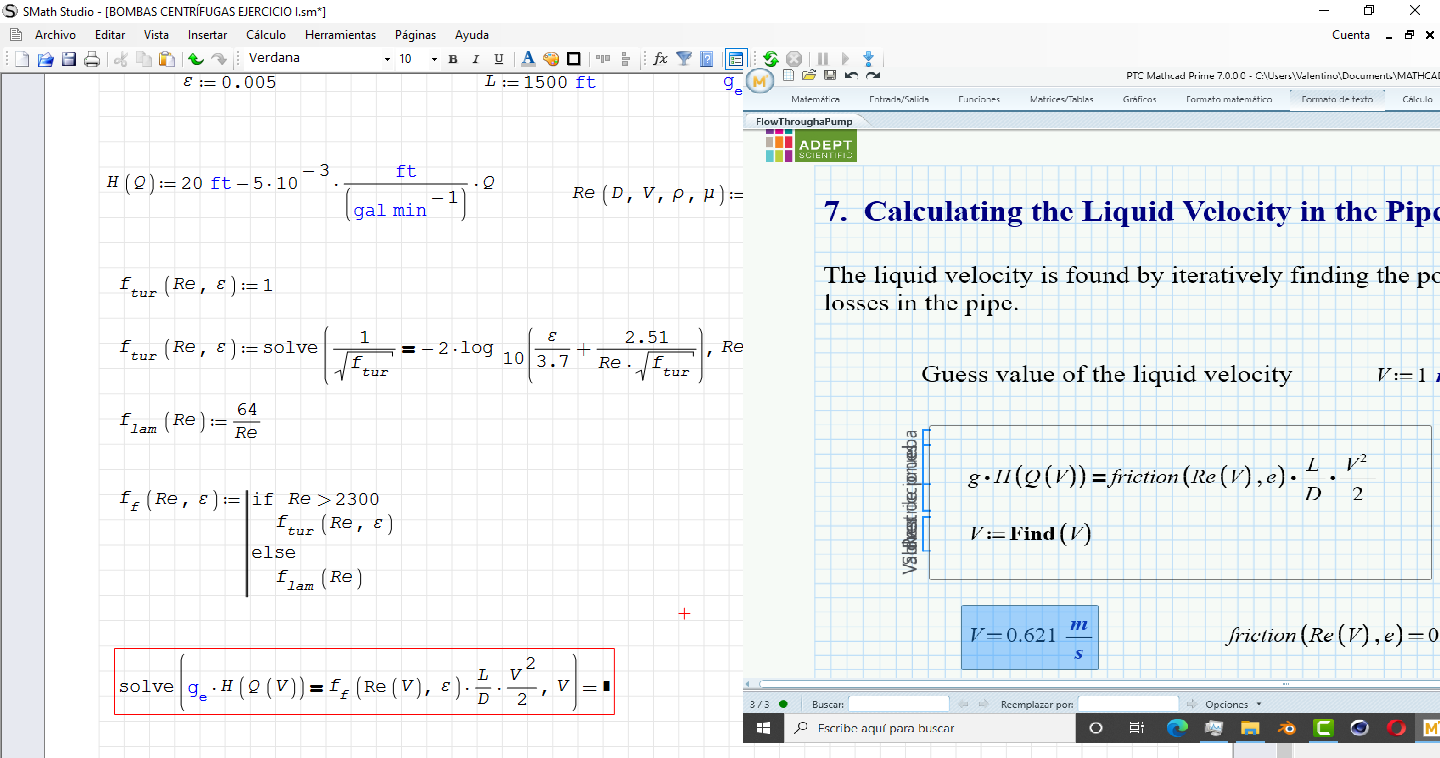

hi guys it's me again xD
There is an exercise to find the discharge speed of a pump in Mathcad Prime ... when I try to do it in SMath Studio I am unsuccessful
Resolving functions based on other functions in SMath Studio - Mathcad Prime
I leave the pdf of Mathcad Prime and the SM File
Liquid Flow Through a Pump.sm (42,2 КиБ) скачан 1155 раз(а).
FlowThroughaPump.pdf (690,73 КиБ) скачан 795 раз(а).

It didn't seem that difficult. Attached as far as I could advance.
Liquid Flow Through a Pump.sm (46,99 КиБ) скачан 1125 раз(а).

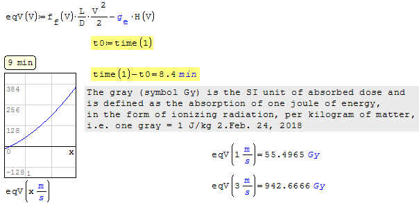

#4 Опубликовано: 03.10.2021 20:42:55
Liquid Flow Through a Pump Brute Force Plot.sm (56,99 КиБ) скачан 1260 раз(а).
