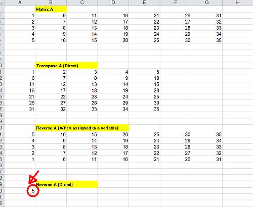

I observe a problem with latest SS (0.99.6873.37652) when exporting a reverse of matrix (A) to Excel, as well as in the earlier version.
It exports correctly the when the reverse matrix is assigned to a variable,
but exports only the first element of A when exported directly.
#2 Опубликовано: 28.10.2018 05:57:20
Confrmed, thank you.
