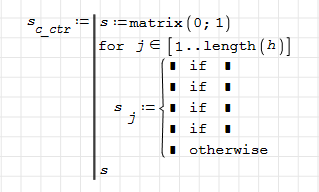

Hi all, new SMath user here (transitioning from Mathcad). I am trying to recreate some of my old Mathcad sheets and have run into an issue for a scenario involving a for loop and multiple if statements. Hopefully this image works:
Any ideas as to what might be going on?
Thanks,

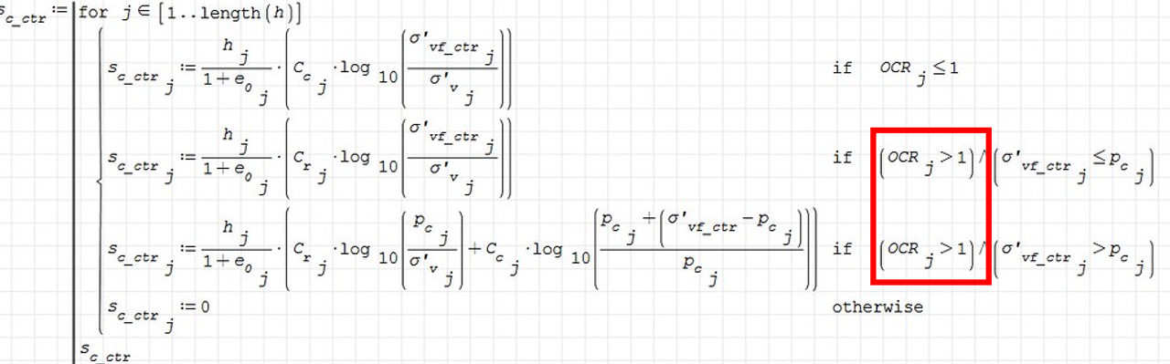

There is room for improvements in the conditions management.
Since the first case catches all the conditions where OCR[j] <= 1, the 2nd and third "(OCR[j] > 1) AND" checks are redundant.
Also, since Sigma'vf_ctr[j] <= pc[j] case is captured in the second condition, the third case can be written in the otherwise placeholder.

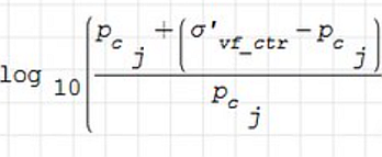

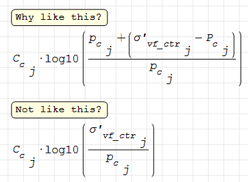

Good catch :-) Here is the conceptual model for the soil consolidation problem which is what this sheet is written to solve. When the final stress exceeds p_c, the soil undergoes additional settlement in the second region whose slope is denoted by C_c. The reason I coded it like that is it makes it easier for me to explain to students that it is an increment of stress (beyond the pressure denoted by p_c) that causes soil settlement in that region.
This is also the reason why I try to code things as explicitly as possible (including in the if statements) so that the students can follow along easier.

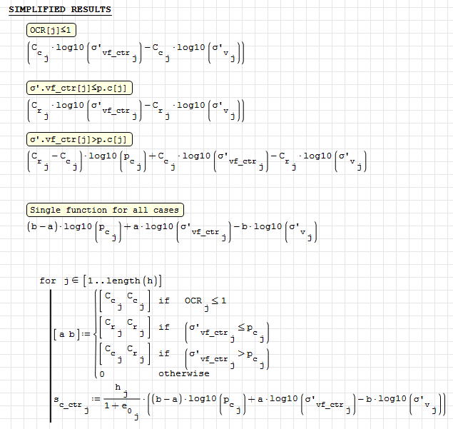

If I didn't made a mistake, this is most simplified I could get.
Here is the file contains logarithmic simplification steps.
cases_simplified.sm (35,71 КиБ) скачан 1385 раз(а).
