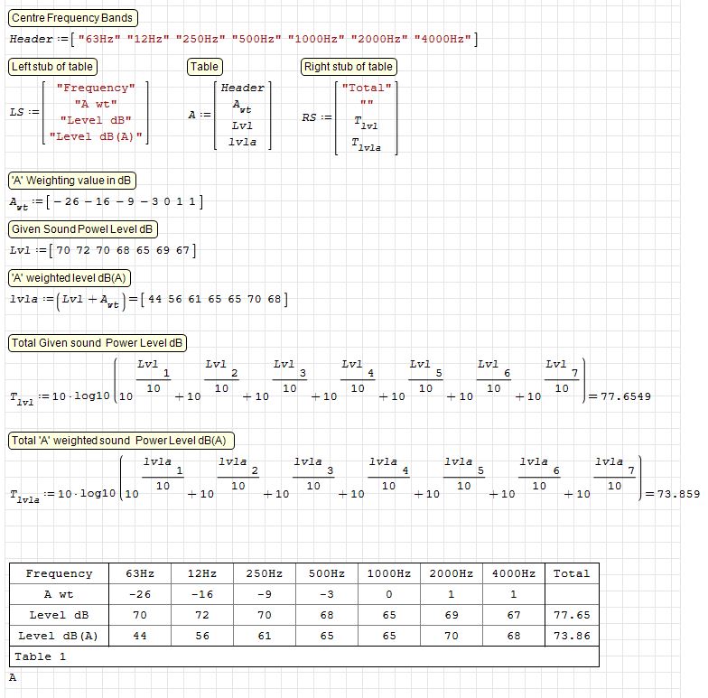

Hi All,
I am trying to work out the 'A' weighting values for sound levels, I have the calculation working, but I would like to simplify the total power levels, by either summation or a loop function. I know how to use summation, but cant get it to work on this.
acoustics 1.sm (17,98 КиБ) скачан 1129 раз(а).

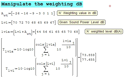

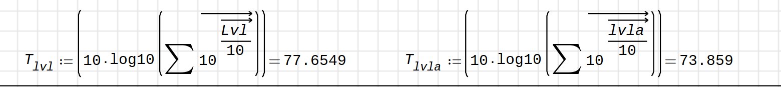

How's this? Using vectorize() function to apply operations to each element in a matrix.
Показать спойлер
acoustics_lyles.sm (14,86 КиБ) скачан 1119 раз(а).

Hi Alyles,
That was exactly what i was looking for thank you.
#4 Опубликовано: 20.10.2019 13:46:18
alyles,
maybe there's an excess of vectorization
