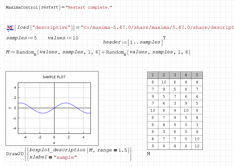

i'm studying SMath with Maxima (written by Dr. Kraska)
boxplot_description(M, option1,...)
but i did not get the result.
boxplot_description.sm (22,99 КиБ) скачан 776 раз(а).

You can either put the commands inside Draw2D() and put this in the placeholder of an image region (Insert> image) or you put the commands directly in the placeholder of a Maxima-Draw2D region. You mixed the approaches.
See the introductory text in the Chapter Plotting with Maxima.

thank you.
