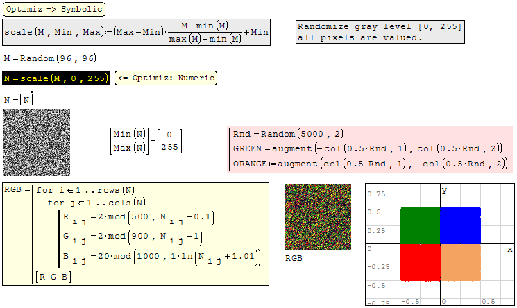

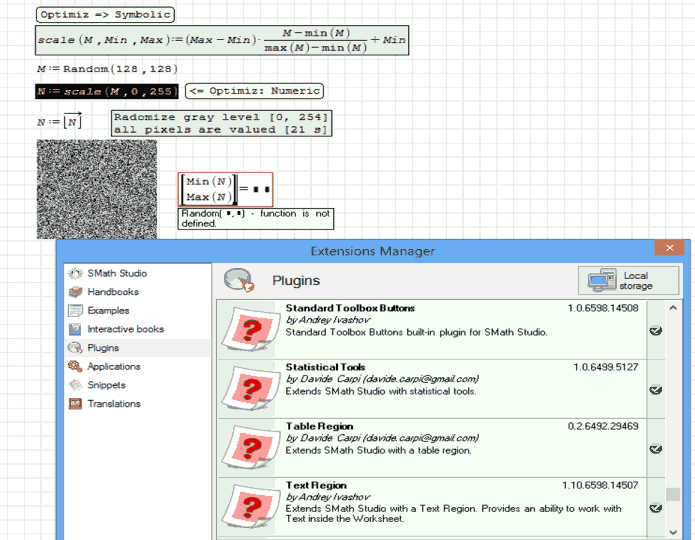

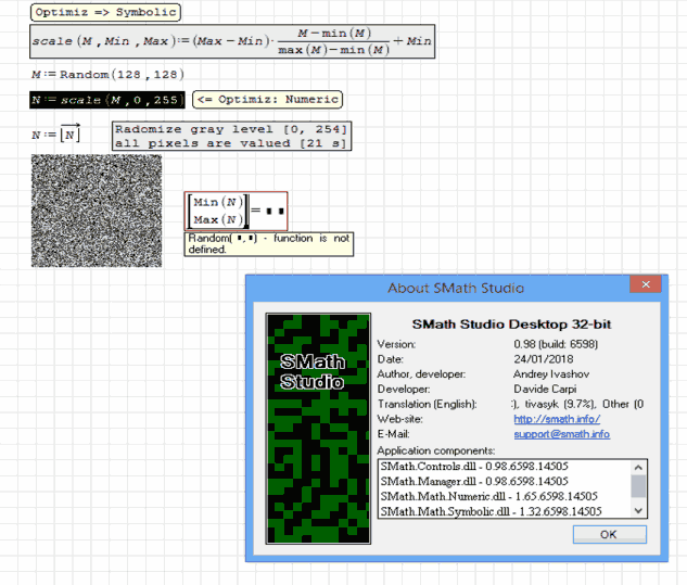

Thank you very much Alyles for your answer, now I have Smath Studio in 32 bits,
but even so I can not follow the example of Jean called "Page1 Randomize Matrix.sm",
it gives me the error "Random () Function is not defined
Carlos
#6 Опубликовано: 24.01.2018 18:40:09
Arie
Arie
Carlos,
Do you have the statistical tools plugin installed?
That is required for the Random(2) function.
#7 Опубликовано: 24.01.2018 19:50:50
CBG
CBG
Цитата
Carlos,
Yes I have it
Carlos
#8 Опубликовано: 25.01.2018 05:45:48
Carlos, could you try if the problem persits even in a portable distribution? (here the one shared by Martin Kraska, here instructions to make one by yourself)
#9 Опубликовано: 25.01.2018 13:18:40
CBG
CBG
Davide, previously had already checked with the portable
distribution of Martin Kraska and the file runs without
any problem, recognizing the statistical functions.
As the portable distribution is 32 bits, I thought that
the problem was that Smath Studio to 64 bits, did not
recognize the statistical tools plugin

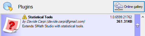

From your screenshot seems that the plgin is recognized (green in loaded plugins) but the functions are not loaded for some reasons. I have recompiled the plugin for the latest SS beta, please try if this works for you (plugin recompiled as beta too).
#12 Опубликовано: 25.01.2018 17:56:33
CBG
CBG
Hello Davide
The plugin has a very strange behavior.
I deleted the current plugin and loaded the updated, ran the file and executed perfectly.
I closed smath studio and reopened it, ran the file again, and the statistical functions were not recognized again.
Carlos

On the other hand the matrix size is too huge for 6179.
Alternately, it turns the work sheet blank, open new sheet, go back.
Instead of turning blank, it may just reply Random(,,) Not defined.
On the other hand, the new Smath 64 bits may not be be compatible to
the maybe 32 bits Statistical plugin. If so, real disaster ...
it would turn red ~ 3 dozens documents from my collection [suicide case].
Added: a refreshed version.
Random_5 Matrix [RGB].sm (102,19 КиБ) скачан 793 раз(а).
