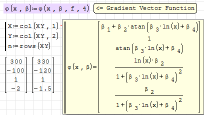

5. max/min of vector function(s) [example attached]

#5 Опубликовано: 22.06.2018 00:03:50
Do you have that in Mathcad ... hover the pointer on the function.
... forgot to attach the document.
Genfit [HV_WEZ].sm (39,66 КиБ) скачан 1426 раз(а).

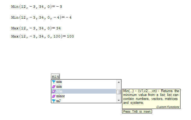

Min() and max() functions ought be overloaded to also accept multiple arguments (same functionality as Mathcad). Or provide an easy way to convert the old mathcad files.
If you install the custom functions plugin, it includes functions that do this.

Example of Min/Max functions:
