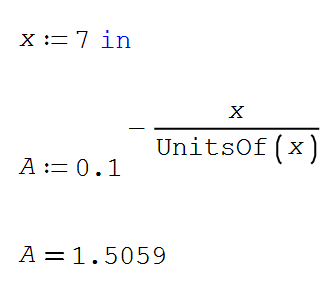

#8 Опубликовано: 20.05.2023 18:27:54
How do I ignore the units for x=7 in when used in the A=x^2 formula? ...
Hi. Something like this?

@Razonar
Not sure. If I use 'A' in another equation, will it consider the units for A?
I dont what it to as it will mess up the units for that answer...which will mess up the units for the subsequent equation.
#10 Опубликовано: 21.05.2023 19:12:35
The choice as to whether you want to use A with or without units is yours. You can use the version of A with units, or the version of A without units. But not both at the same time.

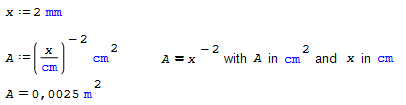

#11 Опубликовано: 22.05.2023 06:49:46
I have:
x=number (inches)
A=x^-number
A= decimal number.fraction (unit)
Why am I getting a results that is a product of decimal and fraction rather than a decimal or fraction?
The unit seems to be only for the fraction.
I am not sure how to paste my results from SMath Studio.
Such problems usually emerge if you have an equation where the variables aren't meant to be numerical values of quantities given in a particular unit rather than being real physical quantities (number times unit).
SMath is designed for work with quantity times unit variables. If you want to use an empirical equation, you also must provide the units of each variable (be it input or result).
You can integrate such equations into a world of proper handling of physical quantites by dividing each input parameter by the unit in which it is supposed to be inserted and by multiplying the expression by the unit in which the result is supposed to be given by that empirical model.
Worksheet2.sm (5,34 КиБ) скачан 1312 раз(а).

#12 Опубликовано: 22.05.2023 11:35:24
... You can integrate such equations into a world of proper handling of physical quantites by dividing each input parameter by the unit in which it is supposed to be inserted and by multiplying the expression by the unit in which the result is supposed to be given by that empirical model.
That is a very smart recommendation.
