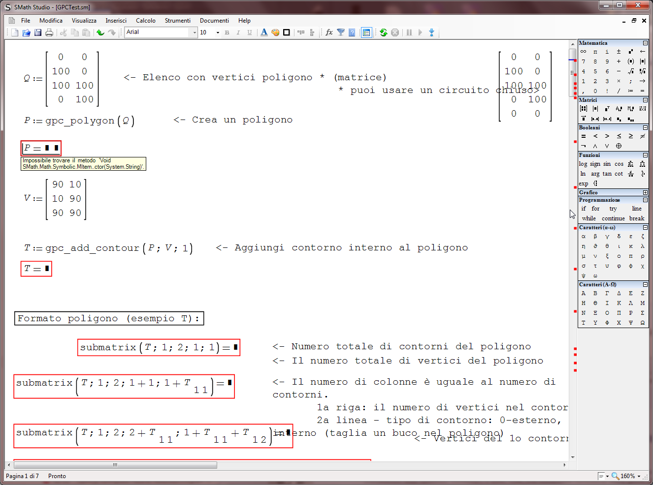

#7 Опубликовано: 28.10.2019 13:14:05
The plugin GPC Wrapper seems it does not work with build 7219
(Could not find the "Void" method)
#8 Опубликовано: 29.10.2019 13:26:41
Thank you Sergio, I will look at it as soon as I can.

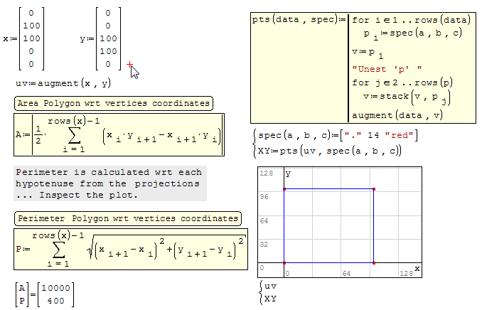

#9 Опубликовано: 29.10.2019 16:10:38
What about closing the polygon ?
#10 Опубликовано: 29.10.2019 16:37:29
Jean,
the plugin provided for the double chance (as can be seen in the upper left of my screenshot) but at the moment with the updated smath version (7219), does not work.
#11 Опубликовано: 16.11.2019 13:41:18
Fixed for latest available Nightly Build (0.99.7250)
