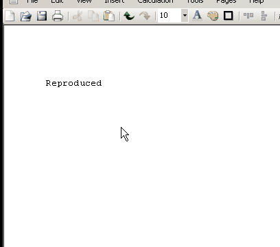

Hi all,
Seem it's not possible to use the product(#,#,#,#) function when you type on the canvas: product(
No issues from Dynamic assistance and Functions Toolbox.
Can someone confirm this?
regards,
w3b5urf3r
P.S. the function product(1) it's not yet implemented
P.P.S. the function int(2) exist but it's not visible in the dynamic assistance
#2 Опубликовано: 12.01.2013 09:19:01
Hello w3b5urf3r,
Confirmed.
I remember that kind of bugs has been reported before (see mess on the screen, for instance). By the way, sometimes is hard to find out if the bug has been already reported or not, although we could be quite sure that it actually was. Nevertheless, we can reported them again/
Davide Carpi 12.01.2013 10:44:00
#3 Опубликовано: 30.04.2013 18:17:38
Thank you! Fixed.
SMath Studio supports this function only for drawing, but not calculating.
