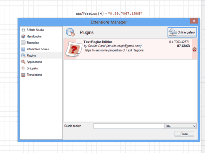

#1 Опубликовано: 24.05.2019 00:12:06
CBG
CBG
Carlos
#2 Опубликовано: 24.05.2019 03:03:31
Thank you, it is related with a change in the API and should be fixed in one of the next SS releases.

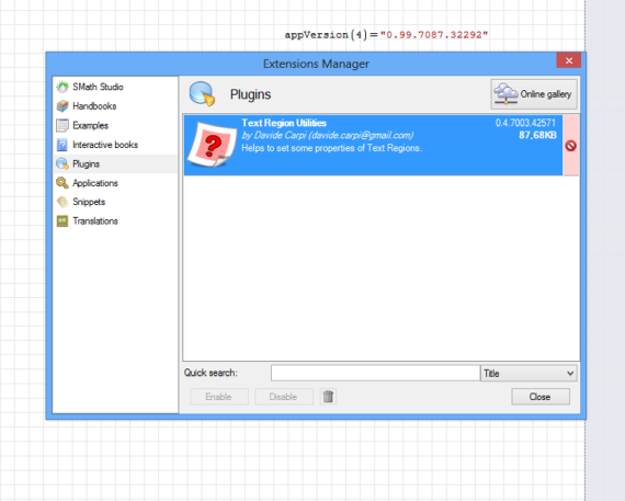

Hello Davide.
The new released version of Smath Studio 0.99.7057.32292 has the same problem as
the previous version 0.99.7067, and does not accept the Text Region Utilities plugin.
Carlos
#4 Опубликовано: 30.05.2019 13:24:29
Fixed in latest beta (just released).
sergio 30.05.2019 13:44:00, Davide Carpi 30.05.2019 15:33:00
#5 Опубликовано: 30.05.2019 13:47:19
CBG
CBG
Thank you very much for your support

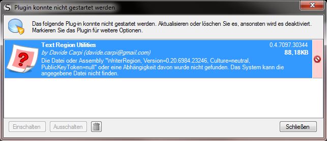

I just installed the latest beta (0.99.7100). I still get the message, that "Text Region Utilities" can not be startet.
It also did not work in the beta (0.99.7097).
System: Windows 7 x64
The program keeps telling me that "The file or assembly 'Writer Region, Version=0.20.6984.23246, Culture=neutral, PublicKeyToken=null' was not found."
#7 Опубликовано: 18.06.2019 08:52:36
do you have the latest Writer Region installed? (WR 0.20.7097.27665 in SS 0.99.7100)
#8 Опубликовано: 18.06.2019 11:21:49
flou_m
flou_m
Thank you very much for the advice.
After reinstalling the Writer Region Plugin (now 0.20.7079.27665) everything works.
