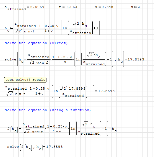

I have spent hours on solving the below equation on MathCad or Excel....however got nowhere
Can anyone please able to help me?
As you can see in the equation below, I have to plot the value of hc but its located on both right and left side of the equation. All other variable (ao, f and v etc.) are constants.

The equation it's not visible, could you attach a SMath file to the post?
However you can use the solve function (here there is an example for an implicit equation)

I attach here the SMath solution for your question.

Excellent, thanks w3b5urf3r! That answer is close to what I was looking for!

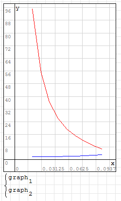

: In the above example, I assumed that hc is not a function of any other additional variable. What if, in the same equation, variable f is a function of x (like f=2x, where x range from 0 to 1 (0, 0.1, 0.2, 0.3..1). Can we then plot hc as a function of x on a graph using SMath?

You can do it in different ways; in the attached example I define a vector of x values (using the range() function) and then I've solved an equation for each x value with a loop and then I create the matrix to plot. Obviously if you know very well the output behavior you can do all the operations "on the fly", inside the loop.

Thanks w3b5urf3r! This is terrific.
I have spent a few hours on SMath and it looks very user-friendly. It has similar feeling of using Mathcad but much faster with some differences.
