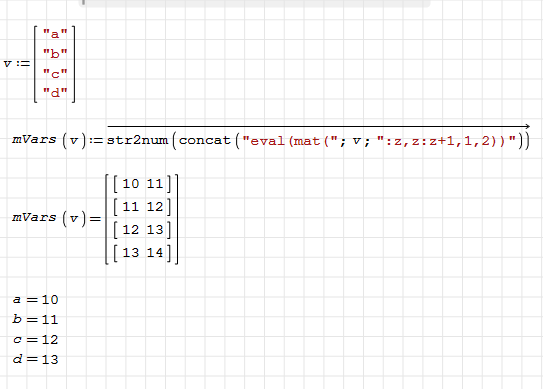

#2 Опубликовано: 07.07.2023 05:06:15
That's one of the other options.

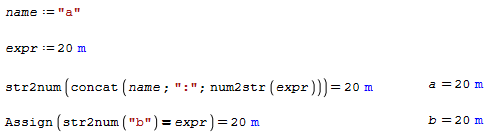

#4 Опубликовано: 07.07.2023 20:02:53
If the value to be assigned is an ordinary expression, then just convert it to a string before using the above-mentioned methods.
asg.sm (4,31 КиБ) скачан 1269 раз(а).

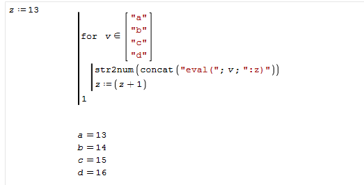

#5 Опубликовано: 07.07.2023 23:52:52
Thanks, unfortunately value to be assigned is supposed to come from somewhere else, z was just an example because I didn't want to make example with large vectors or matrices to be assigned.
Something like this?
z can be anything and come from anywhere.
As long as it has same length with v.
StrAssign.sm (6,91 КиБ) скачан 1219 раз(а).
