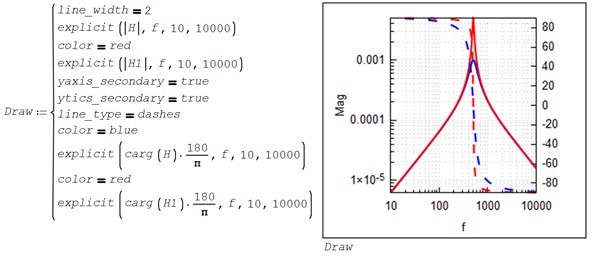

I am a new user of SMath. I mainly use it for control system analysis and drawing Bode plots for transfer functions.
I am trying to figure out how to change the marker for different curves. I use Maxima plugin.
Please see my attached file.
ThanksTF.sm (53 КиБ) скачан 1265 раз(а).

Thanks for your reply.

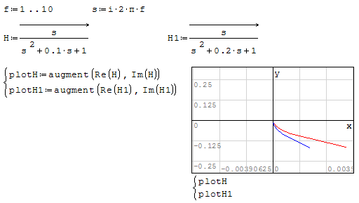

What I was trying to figure out is how to change the marker point for curves for better visualization. I could find out how to changes the line width and color in Maxima as you can see in my file.
It is easy to do it with X-Y plot but I needed log scale and it is available in Maxima.

Hi. Use line_type≡dashes. Other types are dots, short_dashes, short_long_dashes, short_short_long_dashes and dot_dash
