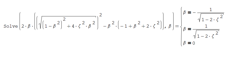

I want to get the real root in symbolic (in red frame) , but solve and maple solve always give me imaginary root (in blue frame).

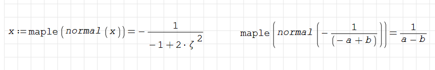

#2 Опубликовано: 01.09.2025 18:09:17
1 554 сообщений из 1 864 понравились пользователям.
The answer is correct. The appearance may differ.
The appearance can be normalized, but it doesn't work in this case.
Отредактировано 01.09.2025 18:12:55
#3 Опубликовано: 01.09.2025 18:52:05
Oscar Campo
Oscar Campo
A simple option is force to find a real solution doing:
then...
best,
Oscar
netsonicyxf 02.09.2025 02:50:54

#5 Опубликовано: 02.09.2025 08:40:47
Hi. Using isol:
isol web.sm (223,27 КиБ) скачан 1079 раз(а).
netsonicyxf 05.09.2025 13:02:29
