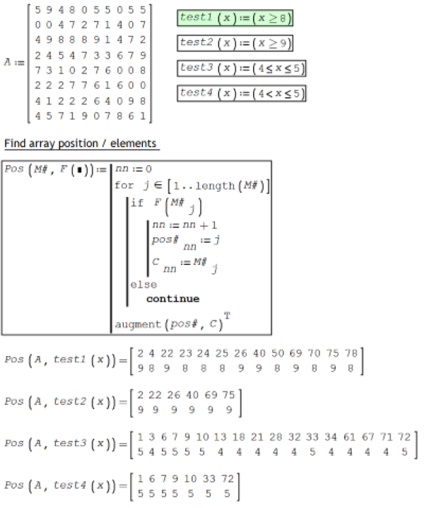

RegRetired

Hi. This is an option.
MFind.sm (14,22 КиБ) скачан 1349 раз(а).
MFind.pdf (58,83 КиБ) скачан 808 раз(а).

#5 Опубликовано: 27.06.2023 12:13:11
NDTM Amarasekera
NDTM Amarasekera
Another method
Array_Pos.sm (14,76 КиБ) скачан 1243 раз(а).

Ndtma,
Thanks; however, I don’t understand the large numbers in your answer, which are greater than the size of the matrix.
Sorry for my lack of understanding.
Reg CurryLoveland, CO
#7 Опубликовано: 27.06.2023 16:48:45
Ndtma,
It's the item position by linear indexing. Elements can be accessed using a single index, that is the position sorted by rows (base 1). f.e. The 2nd element in the 3rd row is indexed (3-1)*cols(matrix)+2
