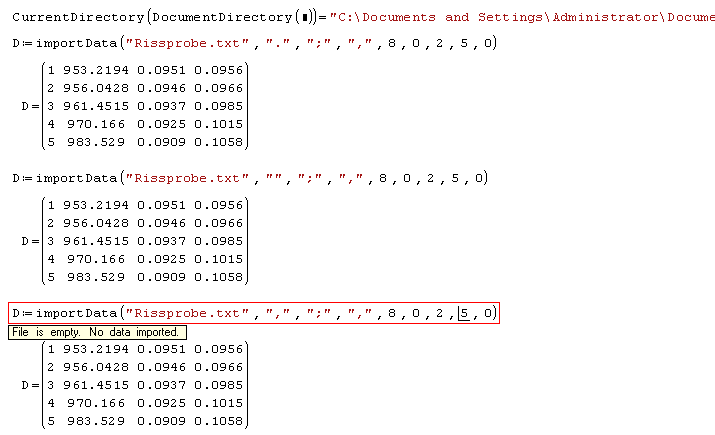

Same result as your if I use comma as decimal separator and semicolon as argument separator
the result below is if I use period as decimal separator and comma as argument separator
