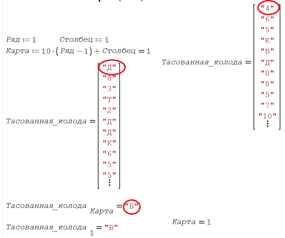

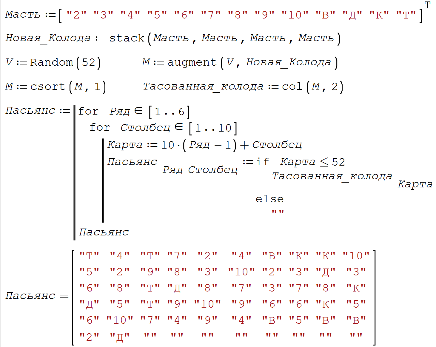

It is one strange bug, I think.
Without the program - all ok!
Patience.sm (37,01 КиБ) скачан 1479 раз(а).
Greetings,

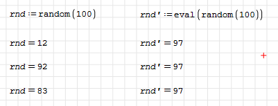

I wasn't able to reproduce the error, but it appears as if the Random() function is somehow redefining your variable every time you call "Тасованная_колода" to display.
