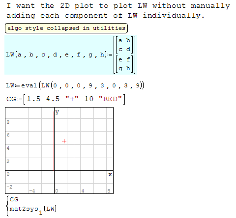

hi,
I am trying to create a sheet to design welds and want to plot the geometry of the weld lines.
the problem is if I assign a matrix with x,y coordinates the 2D plot will draw a continuous function connecting all points, and when I assign this to a discrete matrix of line coordinates it does not plot unless I assign each line individually which is bad as I want it plotted based on the geometry.
in the example below, I want the 2D plot to plot LW without manually adding each component of LW individually.
Thanks

One possible options mat2sys.1() function.
test_alyles.sm (35.91 KiB) downloaded 1208 time(s).
... make it algo style. CG can be managed as well.

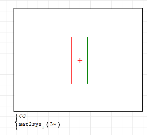

#5 Posted: 11/8/2022 4:51:40 PM
... it may be possible to make svg [Scale Vector Graphic].
Cheers ... Jean.
test_alyles & jean.sm (41.37 KiB) downloaded 1200 time(s).
#6 Posted: 11/8/2022 8:36:11 PM
... this is NOT a graph. It is an image triplet.
1. You can size the thickness/magnitude of the CG
2. You size length/thickness/color of the side welds
3. re-dispose the final triplet.
Cheers ... Jean.
#7 Posted: 11/8/2022 10:08:39 PM
... here is the project as offered.
Utilities Discrete COMPANION_2 WELD.sm (20.2 KiB) downloaded 1241 time(s).

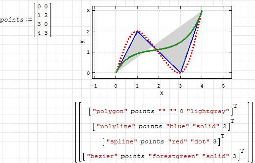

You might consider building geometry plots from the pre-defined objects in the XY-Plot-plugin.
4 users liked this post
sergio 11/9/2022 7:36:00 AM, NDTM Amarasekera 11/9/2022 9:42:00 AM, Arie 11/9/2022 9:42:00 AM, Alvaro 11/9/2022 6:32:00 PM
#9 Posted: 11/9/2022 6:34:13 PM
You might consider building geometry plots from the pre-defined objects in the XY-Plot-plugin. ...
And maybe you may be interested in this other Martin' post, if you want to draw steel profiles to be welded, and by the way calculate their mechanical parameters: https://en.smath.com/forum/yaf_postsm78221_Split-Areas-Polygons-convex-and-concave--by-lines.aspx#post78221
