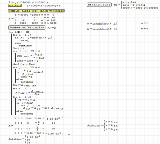

Based on this the author & using an online LP solver I have:
http://prntscr.com/hpk4j5

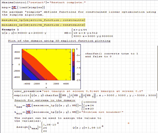

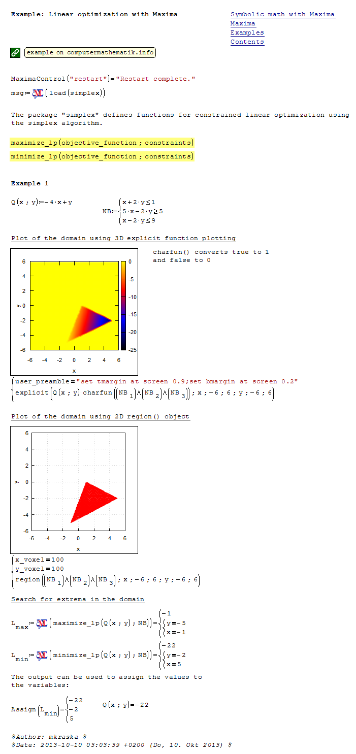

See page Examples> Maxima usage> Linear optimization in the interactive handbook.
Example maxima linear optimization.sm (41.89 KiB) downloaded 1128 time(s).
WroteThanks for the answers Jean would you be kind enough to attach the .sm file too.

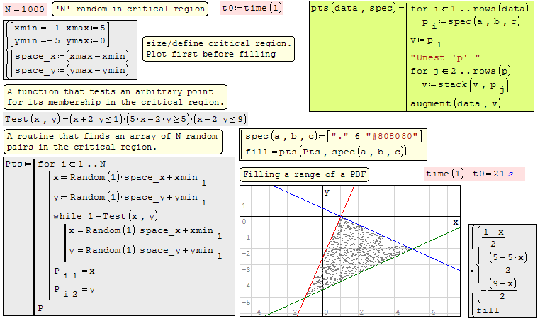

Here is + some extra stuff. Maybe there is way to draw an inscribed 3D ?
Solve GivenFind Critical Region Copy.sm (39.35 KiB) downloaded 1169 time(s).
Metodo_Simplex.sm (52.26 KiB) downloaded 1164 time(s).
Carlos
Small_Simplex_Algorithm.sm (16.35 KiB) downloaded 1190 time(s).
Carlos
CAUTION: The algorithm is NOT TESTED, but it works well for this example.
It is necessary to refine it so that it work in all cases.
Small_Simplex_Algorithm_Improved.sm (88.5 KiB) downloaded 1138 time(s).
Carlos
Now it's fixed.
Small_Simplex_Algorithm_Improved_2.sm (135.66 KiB) downloaded 1166 time(s).
Carlos
WroteI'm sorry, I found a bug in the Simplex algorithm.
That huge number in the program, can be replaced by ∞ [Smath machine number]
RemToDo => check vs Mathcad
First A[i ... badly indexed.
Small_Simplex_Algorithm_Improved_2.sm (140.42 KiB) downloaded 1166 time(s).
Thanks Jean, Now we just have to continue testing the Simplex algorithm, to identify possible faults.
regards
Carlos
