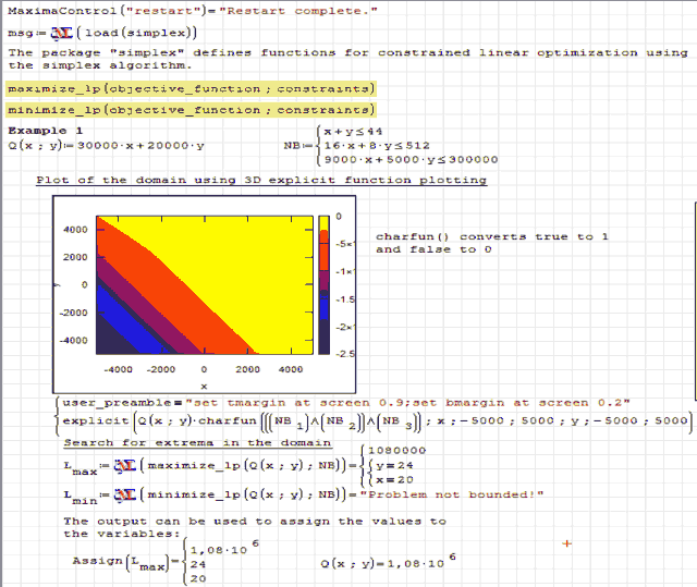

Based on this the author & using an online LP solver I have:
http://prntscr.com/hpk4j5

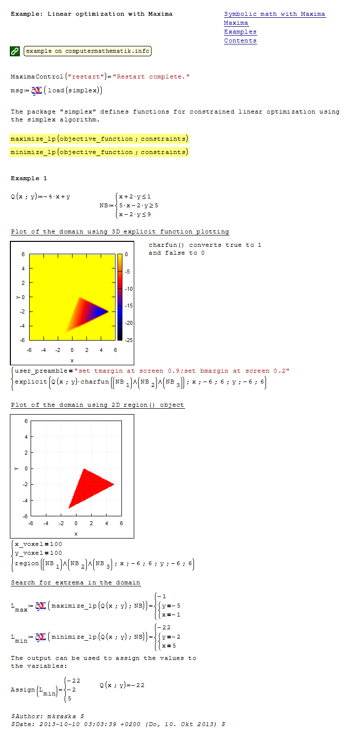

See page Examples> Maxima usage> Linear optimization in the interactive handbook.
Example maxima linear optimization.sm (41,89 КиБ) скачан 722 раз(а).
WroteThanks for the answers Jean would you be kind enough to attach the .sm file too.

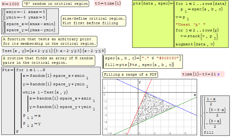

Here is + some extra stuff. Maybe there is way to draw an inscribed 3D ?
Solve GivenFind Critical Region Copy.sm (39,35 КиБ) скачан 763 раз(а).
Metodo_Simplex.sm (52,26 КиБ) скачан 769 раз(а).

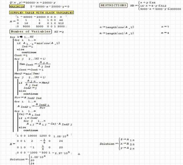

Carlos
Small_Simplex_Algorithm.sm (16,35 КиБ) скачан 775 раз(а).
Carlos
CAUTION: The algorithm is NOT TESTED, but it works well for this example.
It is necessary to refine it so that it work in all cases.
Small_Simplex_Algorithm_Improved.sm (88,5 КиБ) скачан 738 раз(а).
Carlos
Now it's fixed.
Small_Simplex_Algorithm_Improved_2.sm (135,66 КиБ) скачан 769 раз(а).
Carlos
WroteI'm sorry, I found a bug in the Simplex algorithm.
That huge number in the program, can be replaced by ∞ [Smath machine number]
RemToDo => check vs Mathcad
First A[i ... badly indexed.
Small_Simplex_Algorithm_Improved_2.sm (140,42 КиБ) скачан 769 раз(а).
