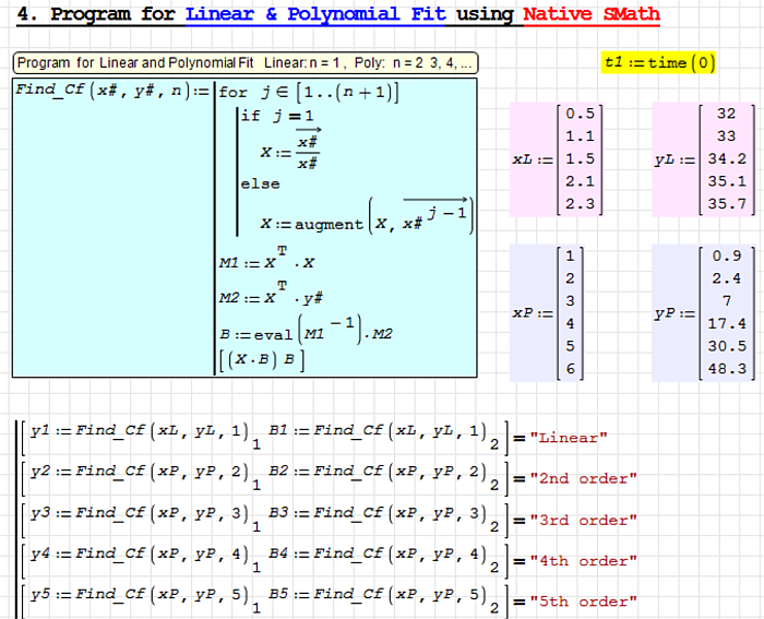

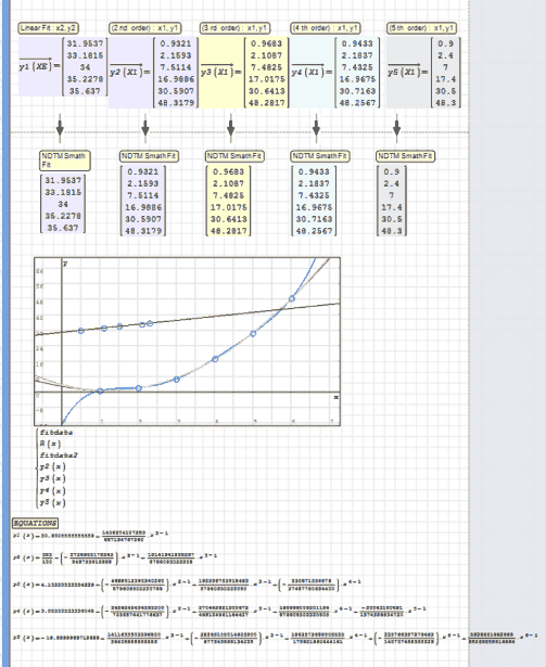

Simple examples on Linear and Polynomial fittings included as follows. This may be useful for beginners.
Examples 1 to 3 are for comparison only. Plot of given data is necessary to guess the distribution.
1. Ex. 1: Quadratic, posted by Martin
2. Ex.2: Ex.1 using SMath
3. Ex.3. Linear
4. Ex.4: A simple program to determine a suitable Linear / Polynomial fit to such data.
1.0 Linear & Poly Fits.sm (738.92 KiB) downloaded 1275 time(s).

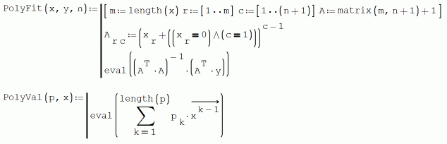

Hi. This is another approach.
PolyFit.sm (18.44 KiB) downloaded 1215 time(s).
PolyFit.pdf (162.98 KiB) downloaded 787 time(s).

Hi. Here
the code (el(x,r)≡0)&(c≡1) for construct the Vandermonde matrix is for avoid 0^0, which returns the error.
Also, I avoid augment in the recursive loops because it's frustratingly slow.
Finlay, the code for PolyVal it's very inefficient, it's only for pedagogical purposes. Horner must be implemented for some other application. Notice that both are matlab/octave/scilab routines too.
In my opinion, the intention of Nugegodage to replicate ms excel results in SMath is very important, to promote SMaths as better alternative to excel doing math.

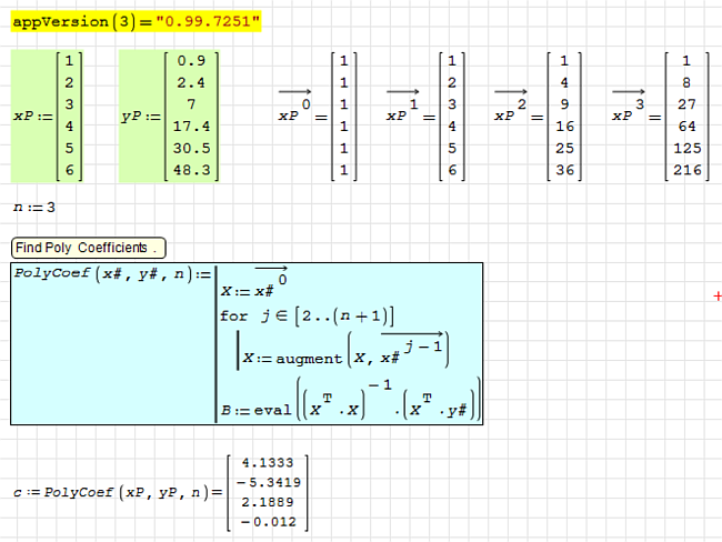

#17 Posted: 12/10/2019 11:58:52 PM
Hi. R2 like ms excel added. And tome other alternatives for solve the matrix.
PolyFit.sm (152.04 KiB) downloaded 1223 time(s).
PolyFit.pdf (693.6 KiB) downloaded 769 time(s).

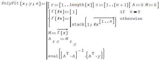

#19 Posted: 12/11/2019 5:33:00 AM
Martin_B
Martin_B
22 likes in 84 posts.
That's my solution
- to separate the functions from matrix building,
- to use vectorize for speed
