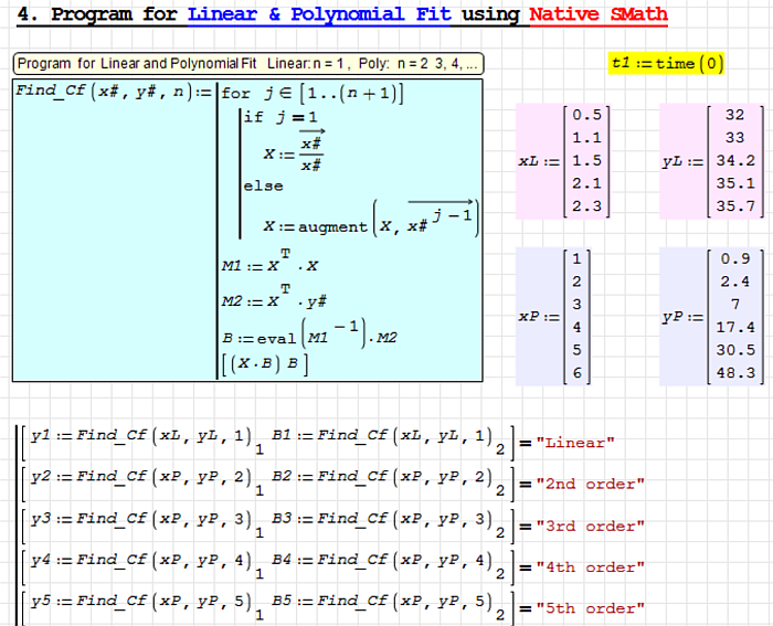

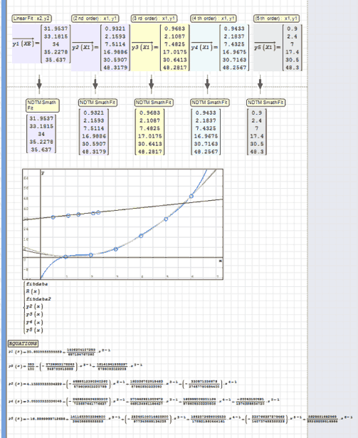

Simple examples on Linear and Polynomial fittings included as follows. This may be useful for beginners.
Examples 1 to 3 are for comparison only. Plot of given data is necessary to guess the distribution.
1. Ex. 1: Quadratic, posted by Martin
2. Ex.2: Ex.1 using SMath
3. Ex.3. Linear
4. Ex.4: A simple program to determine a suitable Linear / Polynomial fit to such data.
1.0 Linear & Poly Fits.sm (738,92 КиБ) скачан 1275 раз(а).

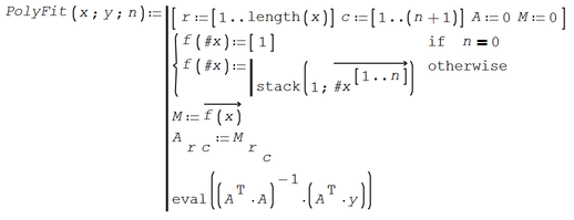

#7 Опубликовано: 09.12.2019 10:32:33
Hi. This is another approach.
PolyFit.sm (18,44 КиБ) скачан 1215 раз(а).
PolyFit.pdf (162,98 КиБ) скачан 787 раз(а).
NDTM Amarasekera 09.12.2019 13:31:00, frapuano 09.12.2019 14:41:00, sergio 09.12.2019 11:46:00

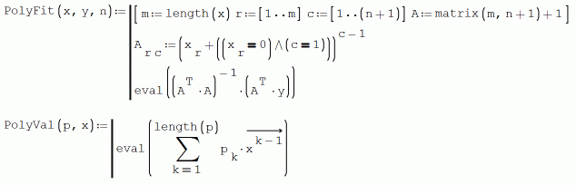

Hi. Here
the code (el(x,r)≡0)&(c≡1) for construct the Vandermonde matrix is for avoid 0^0, which returns the error.
Also, I avoid augment in the recursive loops because it's frustratingly slow.
Finlay, the code for PolyVal it's very inefficient, it's only for pedagogical purposes. Horner must be implemented for some other application. Notice that both are matlab/octave/scilab routines too.
In my opinion, the intention of Nugegodage to replicate ms excel results in SMath is very important, to promote SMaths as better alternative to excel doing math.

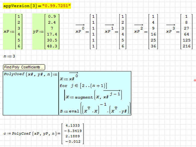

#17 Опубликовано: 10.12.2019 23:58:52
Hi. R2 like ms excel added. And tome other alternatives for solve the matrix.
PolyFit.sm (152,04 КиБ) скачан 1223 раз(а).
PolyFit.pdf (693,6 КиБ) скачан 769 раз(а).
