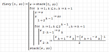

#4 Posted: 10/27/2023 9:48:23 PM
Valery Ochkov
Valery Ochkov
66 likes in 697 posts.
Я просил анимацию фрактала Леви.
А вы мне высыпали все, что у вас есть!

http://twt.mpei.ac.ru/MCS/Worksheets/Levy-curve.xmcd

#9 Posted: 10/30/2023 3:32:18 AM
598 likes in 1,380 posts.
Here is the smath file for that mathcad example.
fractal_levy.sm (9.99 KiB) downloaded 1326 time(s).
Valery Ochkov 10/30/2023 12:42:00 PM, Oscar Campo 10/30/2023 4:07:00 AM
#10 Posted: 10/30/2023 12:42:54 PM
Valery Ochkov
Valery Ochkov
With n=0
Levy-Fractal.sm (12.3 KiB) downloaded 1332 time(s).
Did you seen Levi fractals by n<0 or n not integer?

#12 Posted: 10/30/2023 4:41:29 PM
Using complexes.
fractal_levy-complex.sm (8.7 KiB) downloaded 1358 time(s).
