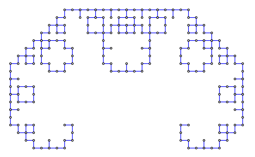

For these two ... simple
Jean.
Pattern Valery.sm (5,03 КиБ) скачан 1368 раз(а).

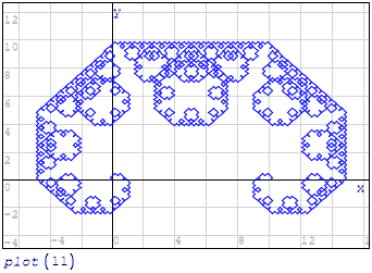

http://twt.mpei.ac.ru/MCS/Worksheets/Levy-curve.xmcd

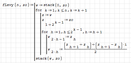

Here is the smath file for that mathcad example.
fractal_levy.sm (9,99 КиБ) скачан 1325 раз(а).

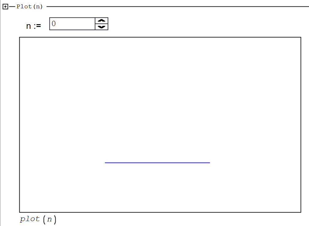

With n=0
Levy-Fractal.sm (12,3 КиБ) скачан 1331 раз(а).
Did you seen Levi fractals by n<0 or n not integer?

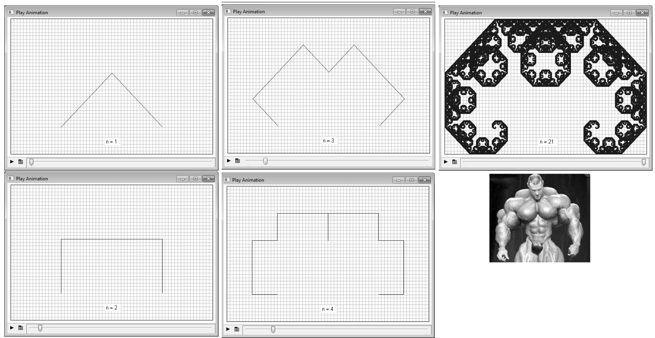

Here is your file with animation added...
Levy-Fractal_animated.sm (24,31 КиБ) скачан 1339 раз(а).
