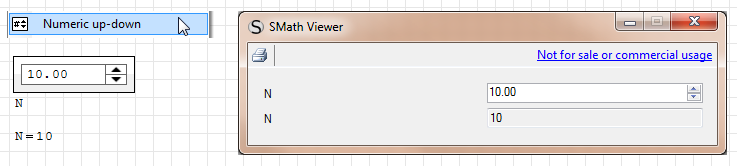

Numeric Up-Down Control.
  • requirements: SS 0.96.5146 or later;
  • installation: SMath Studio: Tools > Plugins... > Online Gallery;
  • documentation: Numeric up-down Region.sm (28.81 KiB) downloaded 1574 time(s).;
  • languages: English;
  • main features:
    - Allowed inputs: region up/down buttons, + and - keys, mouse wheel; hold the input to have more increments.
    - Settings: double-click over the region.
    - Output: place a variable in the region placeholder.
    - Size driven by the value (manual resize not allowed).
    - Adds the same control in SMath Viewer.
>>> PLEASE REPORT IN THIS TOPIC ANY ISSUE, MORE DETAILED AS POSSIBLE <<<

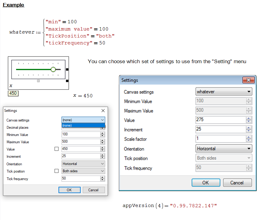

#13 Posted: 10/25/2021 2:12:35 PM
Renzo Choque
Renzo Choque
6 likes in 18 posts.
Hi, it seems that the "canvas setting" field does not recognize the "whatever" variable. I'm using smath in windows 10.Slider.png
#14 Posted: 10/25/2021 9:18:43 PM
598 likes in 1,380 posts.
I think this can be a bug.
When a setting has a string value, it can not be read by canvas settings.
Delete the "TickPosition" = "both" and whatever will be readable again.
I have tried this with "orientation" = "vertical", whatever can't be read by canvas settings.
Deleted the "orientation" = "vertical" element, and it can be available again.
This behavior made me to think there is something wrong while reading strings.
#15 Posted: 10/26/2021 5:58:20 AM
1,443 likes in 2,935 posts.
Thank you, confirmed. I'll fix it ASAP.
You are right, it is related to strings encoding. If you remove the space character from "maximum value" it works as expected.
#16 Posted: 11/1/2021 6:44:42 AM
Issue fixed in both NumericUpDown and Slider regions for latest SS stable and later.

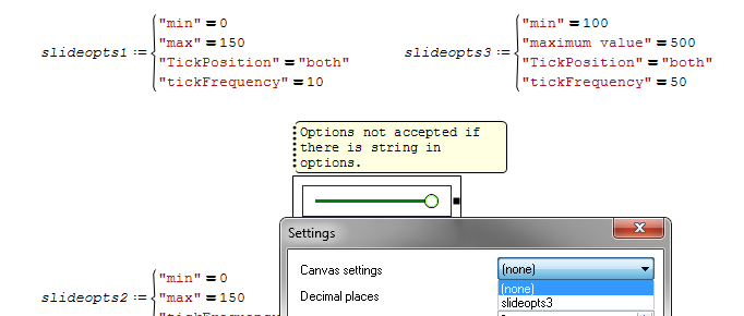

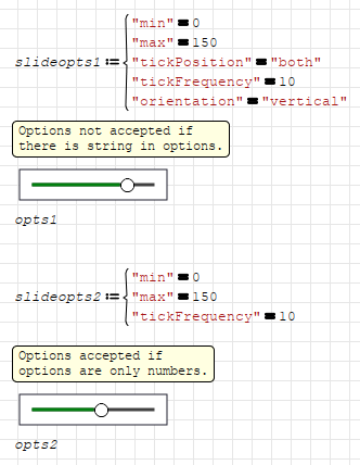

#17 Posted: 11/1/2021 1:56:08 PM
String issue not fixed, at least for linux.
slider_options.sm (4.55 KiB) downloaded 1502 time(s).
#18 Posted: 11/2/2021 5:58:47 AM
Thank you, I can reproduce with your file even in windows... this issue it's something more subtle, though
#19 Posted: 11/2/2021 11:56:10 AM
Found it. You forgot to set the optimization to "none" on definitions, as indicated in the documentation. If you hover over the definition you can see that in both numeric and symbolic optimization the boolean equal between strings is preprocessed and stored as 0.
#20 Posted: 11/2/2021 2:28:13 PM
Thanks, now it works.
To be honest I didn't read the documentation in first post.
I only looked in Reference Book and couldn't see that information in it.
