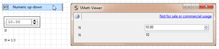

Numeric Up-Down Control.
  • requirements: SS 0.96.5146 or later;
  • installation: SMath Studio: Tools > Plugins... > Online Gallery;
  • documentation: Numeric up-down Region.sm (28,81 КиБ) скачан 1574 раз(а).;
  • languages: English;
  • main features:
    - Allowed inputs: region up/down buttons, + and - keys, mouse wheel; hold the input to have more increments.
    - Settings: double-click over the region.
    - Output: place a variable in the region placeholder.
    - Size driven by the value (manual resize not allowed).
    - Adds the same control in SMath Viewer.

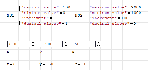

#3 Опубликовано: 18.03.2014 19:18:44
Davide, it seems that description strings of the region are ignored in the viewer. Can that be changed or do I need to use sort of "nice" variable names?
Notenschlüssel.sm (11,53 КиБ) скачан 109 раз(а).

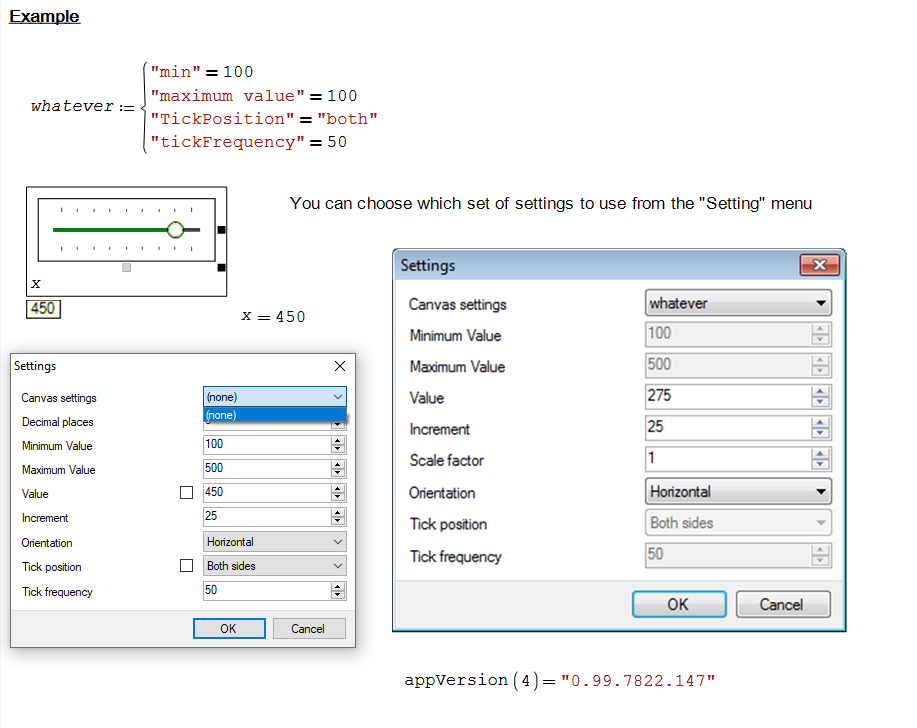

Renzo Choque
Renzo Choque
6 сообщений из 18 понравились пользователям.
Hi, it seems that the "canvas setting" field does not recognize the "whatever" variable. I'm using smath in windows 10.Slider.png
#14 Опубликовано: 25.10.2021 21:18:43
I think this can be a bug.
When a setting has a string value, it can not be read by canvas settings.
Delete the "TickPosition" = "both" and whatever will be readable again.
I have tried this with "orientation" = "vertical", whatever can't be read by canvas settings.
Deleted the "orientation" = "vertical" element, and it can be available again.
This behavior made me to think there is something wrong while reading strings.
#15 Опубликовано: 26.10.2021 05:58:20
Thank you, confirmed. I'll fix it ASAP.
You are right, it is related to strings encoding. If you remove the space character from "maximum value" it works as expected.

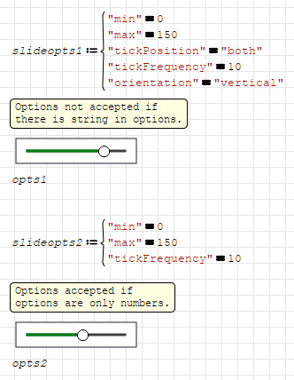

#17 Опубликовано: 01.11.2021 13:56:08
String issue not fixed, at least for linux.
slider_options.sm (4,55 КиБ) скачан 1502 раз(а).

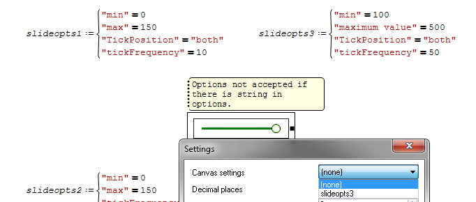

#18 Опубликовано: 02.11.2021 05:58:47
Thank you, I can reproduce with your file even in windows... this issue it's something more subtle, though
#19 Опубликовано: 02.11.2021 11:56:10
Found it. You forgot to set the optimization to "none" on definitions, as indicated in the documentation. If you hover over the definition you can see that in both numeric and symbolic optimization the boolean equal between strings is preprocessed and stored as 0.
#20 Опубликовано: 02.11.2021 14:28:13
Thanks, now it works.
To be honest I didn't read the documentation in first post.
I only looked in Reference Book and couldn't see that information in it.
