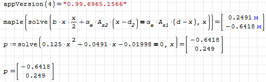

#2 Posted: 1/27/2019 3:05:54 PM
1,555 likes in 1,867 posts.
Alternatively you can try maple() function from the Maple Tools extension.

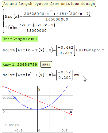

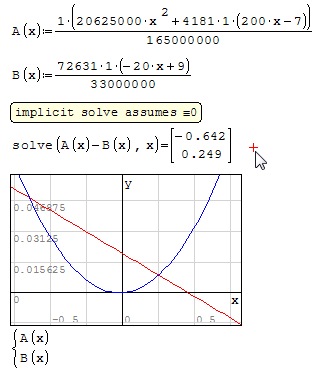

#3 Posted: 1/27/2019 4:14:40 PM
Hello, maybe someone could help
1. recast the functions unitless
2. plot
3. solve implicit in this case.
Davide Carpi 1/28/2019 5:53:00 AM

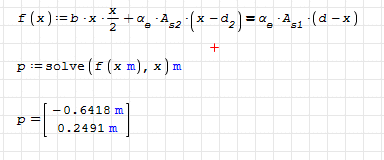

#4 Posted: 1/28/2019 3:56:15 AM
Hi. You need to handle units in the SMath solve function. Here it's a way.

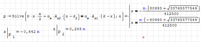

#5 Posted: 1/28/2019 10:29:14 AM
Solve() from the Maxima plugin can handle units directly (symbolic solver)
2019-01-28 14_26_49-SMath Studio - [Gelzbetonines%20konstrukcijos%20ilinkio%20skaiciavimas.sm_].png
frapuano 1/28/2019 12:57:00 PM
