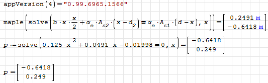

Alternatively you can try maple() function from the Maple Tools extension.
Davide Carpi 28.01.2019 05:53:00

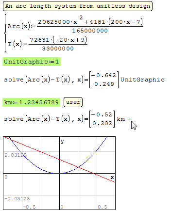

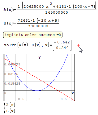

Hello, maybe someone could help
1. recast the functions unitless
2. plot
3. solve implicit in this case.

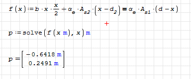

Hi. You need to handle units in the SMath solve function. Here it's a way.

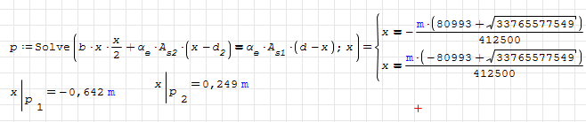

Solve() from the Maxima plugin can handle units directly (symbolic solver)
