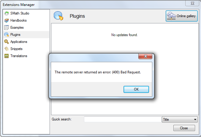

PSS. Once more to note the possible problem when frequantly installing/updating plugins from the Gallery (see the picture). If this happened, the only way is to delete the extension folder, and to install all the plugins again - AFAIK
Normally it is sufficient to delete the most recently installed plugins. Usually I have to delete the Maxima and the TableRegion directories.
I've never experimented the error in your screenshot, in the other hand the plugin updates sometimes (2 times, as for now) causes me workspace's "red cross of death" scrolling up and down worksheets ...

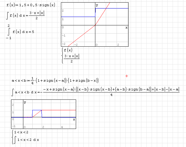

#5 Posted: 11/24/2013 4:00:08 PM
Maxima can integrate piecewise continuous functions, if they do not contain boolean expressions. Fortunately, there are workarounds for that. If you redefine the cases() functions in a similar way as apiecewise.PNG

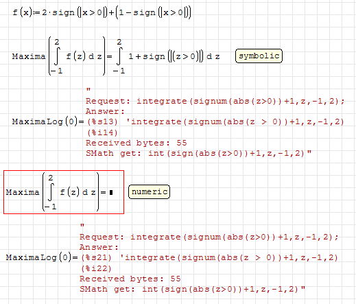

I miss something... why this doesn't work?

#7 Posted: 11/24/2013 4:58:42 PM
Handling of boolean expressions is quite different between Maxima and SMath. The way I proposed is inspired by how Derive (R.I.P.) simplified piecewise functions 20 years ago.
You could use abs() instead of sign(), that might work as well.
From the maxima manual:
The symbols < <= >= and > represent less than, less than or equal, greater than or equal, and greater than, respectively. The names of these operators are "<" "<=" ">=" and ">", which may appear where the name of a function or operator is required.
These relational operators are all binary operators; constructs such as a < b < c are not recognized by Maxima.
Relational expressions are evaluated to Boolean values by the functions is, maybe, if, while, unless. They are not otherwise evaluated or simplified to Boolean values, although the arguments of relational expressions are evaluated (when evaluation is not otherwise prevented by quotation).
[MATH]Maxima(is(1<2))=true@#[/MATH]
I do not understand the expression sign(abs(x>0)). if x>0, then the boolean expression returns 1, otherwise 0. abs() does not change that, neither does sign().
In SMath you can replace a
#8 Posted: 11/24/2013 7:07:21 PM
1,443 likes in 2,935 posts.

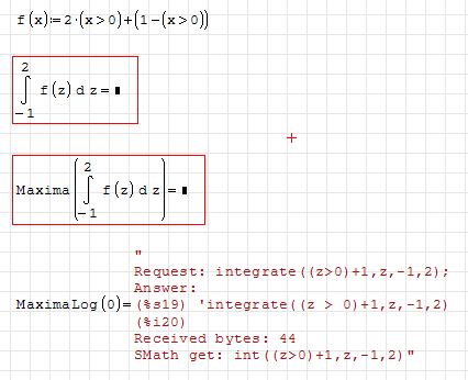

Okay, the problem is that cases output conditions and statements without preprocessing, so there are booleans... Maxima can't add (as general rule) an is() when there are boolean operators, or, if this is not possible, overriding the cases function?
The sign(abs(#)) was to reproduce the actual behavior of the symbolic cases(), that use any 0 value as 'false' and any not null value as 'true' (mainly to skip the preprocessing of the conditions and to avoid scaling factors)

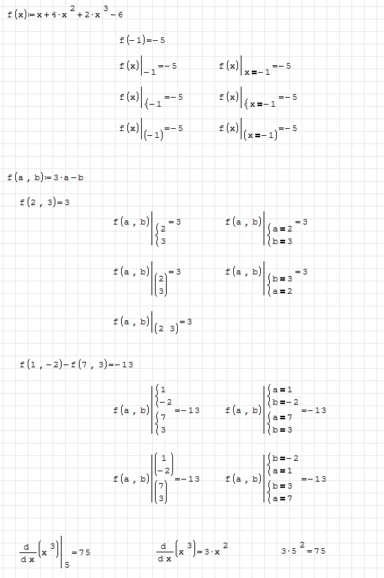

UPDATED
- at(2) and at(3) now are working functions
features:
* implicit equivalence needs a value for each variable, sorted alphabetically;
* with explicit equivalence (variable == value) the replacement could be limited to some unknowns or extended to anyone.
[edit] 1st post documentation updated

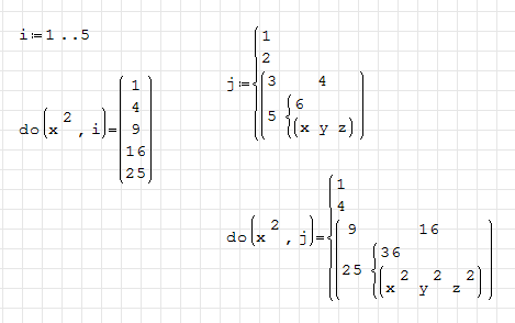

#16 Posted: 5/7/2014 5:47:12 PM
I've never used MathCad but looking the continuous posts the evaluation through vector elements seems like a drug
So I've planned to add something similar in this plugin; here's a screenshot of the undressed working function... I'm looking for a name, I've thinked to do(2) (because is fast to write - but this may be used hereafter for a do statement?) or maybe each(2)... if anyone has some better ideas about the name... b)

I'd propose to limit special formatting of functions to those cases that have a chance of being understood by non-SMath-experts or non-programmers. at(), cases() or the ternary comparisons are very good examples of this approach. That's why the range variables are that popular, because most engineers would understand the index equations.
How would you write your do() functions on paper? That might then inspire the "dressing".
