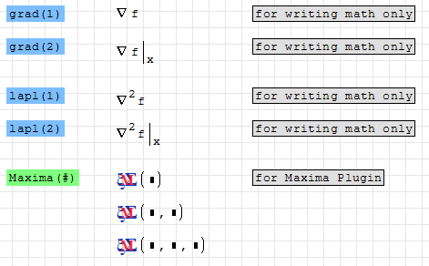

Glyphs for functions

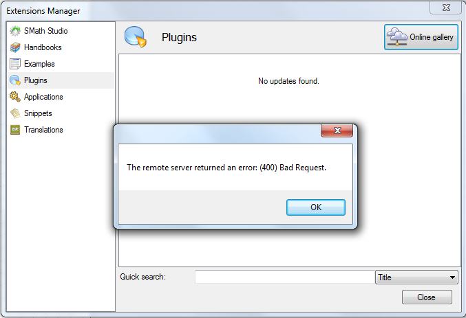

PSS. Once more to note the possible problem when frequantly installing/updating plugins from the Gallery (see the picture). If this happened, the only way is to delete the extension folder, and to install all the plugins again - AFAIK

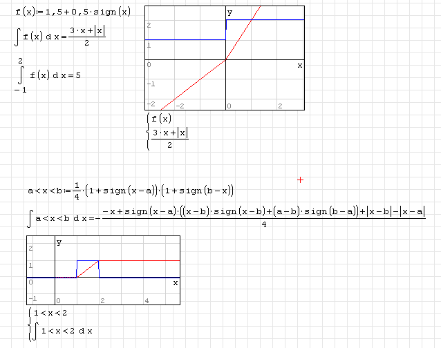

#3 Опубликовано: 24.11.2013 12:36:23
Davide, thanks for the update.
There is still quite something to do until we can symbolically integrate functions involving your operators. Maxima can do that only if the cases expand to sign() and abs() or possibly unitstep(). Perhaps we also could split the integrals appropriately at the interval limits and send the individual functions to Maxima.
The at() operator currently can handle just very special types of expressions. We could map it to the at() function in Maxima, see attachment. We did so with the det() function in the recent update (announcement to come)
Fortunately, we can use distrib package in Maxima
How about posting an example in the Maxima topic of the Samples subforum? Maybe, there are still usability issues which we could fix...
Normally it is sufficient to delete the most recently installed plugins. Usually I have to delete the Maxima and the TableRegion directories.
at.sm (7,13 КиБ) скачан 1661 раз(а).
I've never experimented the error in your screenshot, in the other hand the plugin updates sometimes (2 times, as for now) causes me workspace's "red cross of death" scrolling up and down worksheets ...
I see, I don't know how to fix this (because anyway I'm expecting the use of booleans in the conditions - see the screenshots)
I'd like to add a function to make working at(2) and at(3) (indipendently from the Maxima plugin), let me know what I can do...

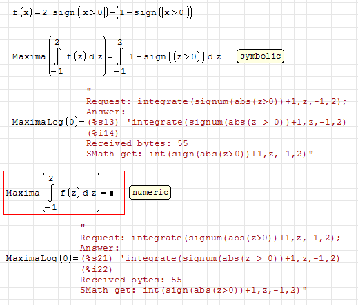

Martin Kraska 24.11.2013 16:03:00

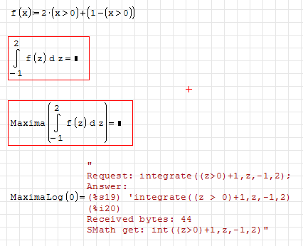

#5 Опубликовано: 24.11.2013 16:00:08
Maxima can integrate piecewise continuous functions, if they do not contain boolean expressions. Fortunately, there are workarounds for that. If you redefine the cases() functions in a similar way as apiecewise.PNG
#6 Опубликовано: 24.11.2013 16:16:02
I miss something... why this doesn't work?
#7 Опубликовано: 24.11.2013 16:58:42
Handling of boolean expressions is quite different between Maxima and SMath. The way I proposed is inspired by how Derive (R.I.P.) simplified piecewise functions 20 years ago.
You could use abs() instead of sign(), that might work as well.
From the maxima manual:
The symbols < <= >= and > represent less than, less than or equal, greater than or equal, and greater than, respectively. The names of these operators are "<" "<=" ">=" and ">", which may appear where the name of a function or operator is required.
These relational operators are all binary operators; constructs such as a < b < c are not recognized by Maxima.
Relational expressions are evaluated to Boolean values by the functions is, maybe, if, while, unless. They are not otherwise evaluated or simplified to Boolean values, although the arguments of relational expressions are evaluated (when evaluation is not otherwise prevented by quotation).
[MATH]Maxima(is(1<2))=true@#[/MATH]
I do not understand the expression sign(abs(x>0)). if x>0, then the boolean expression returns 1, otherwise 0. abs() does not change that, neither does sign().
In SMath you can replace a
#8 Опубликовано: 24.11.2013 19:07:21
Okay, the problem is that cases output conditions and statements without preprocessing, so there are booleans... Maxima can't add (as general rule) an is() when there are boolean operators, or, if this is not possible, overriding the cases function?
The sign(abs(#)) was to reproduce the actual behavior of the symbolic cases(), that use any 0 value as 'false' and any not null value as 'true' (mainly to skip the preprocessing of the conditions and to avoid scaling factors)

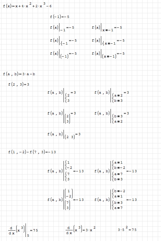

#11 Опубликовано: 10.12.2013 21:10:16
UPDATED
- at(2) and at(3) now are working functions
features:
* implicit equivalence needs a value for each variable, sorted alphabetically;
* with explicit equivalence (variable == value) the replacement could be limited to some unknowns or extended to anyone.
[edit] 1st post documentation updated

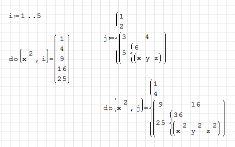

#16 Опубликовано: 07.05.2014 17:47:12
I've never used MathCad but looking the continuous posts the evaluation through vector elements seems like a drug
So I've planned to add something similar in this plugin; here's a screenshot of the undressed working function... I'm looking for a name, I've thinked to do(2) (because is fast to write - but this may be used hereafter for a do statement?) or maybe each(2)... if anyone has some better ideas about the name... b)

#17 Опубликовано: 08.05.2014 04:37:00
Maybe foreach(2) if it is not too long
#18 Опубликовано: 08.05.2014 05:33:25
Davide, thanks for approaching this challenge. I see two different issues:
1. mapping functions or expressions to structures by element vec(expr)
- identify the variables in expression (without preprocessing
- get variable values (structures) from context
- iterate over the elements replacing the element values for the structure variable names in expr and building a result of the same structure as the variables.
This would require the variables in expression to be either of the same structure or scalars. You might relax that condition to variables being of identical length, if linear adressing is unique and well defined. Then you would return a vector of corresponding length.
I think, the right over-arrow just like in Mathcad would be appropriate, even if I'd rather like arrows, overbars or the like to be available as decorations for variable names.
This is essentally what your function do() does already, except that perhaps the function could find out by itself, which variable to iterate over.
2. Implicit loops to generate matrix or vector results. Input is the index equation or it's parts (result name, expression, index names). I failed to provide a working example, the definitions might illustrate, what I mean.
[MATH lang=eng]apply(res,expr,i1,i2):line(expr1:at(expr,sys(i1≡ii1,i2≡ii2,2,1)),for(ii1,i1,for(ii2,i2,el(res,ii1,ii2):expr1)),res,3,1)[/MATH]
[MATH lang=eng]apply(res,expr,i1,i2):line(ii1:i1,ii2:i2,for(i1,ii1,for(i2,ii2,el(res,i1,i2):expr)),res,4,1)[/MATH]
The input
[MATH lang=eng]el(M,i,j):i+j[/MATH]
would be translated to
[MATH lang=eng]apply(M,i+j,i,j)[/MATH]
But that would require your function decorating to cover both sides of an assignment.
The names in my examples are arbitrary, I would stick, however to something like vectorize(), vector() or vec(), as this would be consistent with Mathcad speech and with the decoration symbol.

#20 Опубликовано: 08.05.2014 19:09:38
I'd propose to limit special formatting of functions to those cases that have a chance of being understood by non-SMath-experts or non-programmers. at(), cases() or the ternary comparisons are very good examples of this approach. That's why the range variables are that popular, because most engineers would understand the index equations.
How would you write your do() functions on paper? That might then inspire the "dressing".
