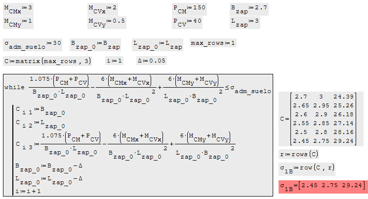

I am learning how to use Smath Studio, I want to write an iteration where an increment of 0.5 is added to two declared variables "a" and "b" which are replaced in a formula and it gives me a final value "X" and the condition is that the iteration stops when the final value is equal to or less than a declared value "Y" to finally extract from the iteration array the row with the three values that meet this condition: [a b X]

This is the structure that I have been writing to iterate but I need to extract the row of interest, which in this example has to be less than or equal to sigma_adm_suelo, this row is the last

Greetings,
You may want to consider the use of a for loop instead of a while statement:
Copy and Paste the following into your worksheet:
line(#,for(i:1,i<10,i:i+1,line(#,#,#,#,4,1)),#,3,1)
May this be of Good Help;
⚜ Kenny Lemens, P.E. ᵂᴵ

The result I am looking for is that it meets the initial condition, how would I stop at the iteration that meets this condition, to be able to do it using the "for" command that you suggested and not the 10 iterations that I declare for "i"

Hola Orlando. You can use break inside the for loop.

Greetings,
The 'i < 10' statement would be replaced with your criteria (ie., ≤ σ.adm_suelo). Regardless, the largest issue you have is with regards to how SMath programs; you need to follow the 'rules' of setting up programming functions within a line() group, where the last item is the value returned as a result.
Copy and paste the following into your worksheet:
C.summary:+line(C:matrix(max_rows:1,3),for(i:1,({1.075*(P.CM+P.CV)}/{B.zap_0*L.zap_0}-{6*(M.CMx+M.CVx)}/{B.zap_0*L.zap_0^2}+{6*(M.CMy+M.CVy)}/{L.zap_0*B.zap_0^2}≤σ.adm_suelo),i:i+1,line(el(C,i,1):B.zap_0,el(C,i,2):L.zap_0,el(C,i,3):{1.075*(P.CM+P.CV)}/{B.zap_0*L.zap_0}-{6*(M.CMx+M.CVx)}/{B.zap_0*L.zap_0^2}+{6*(M.CMy+M.CVy)}/{L.zap_0*B.zap_0^2},B.zap_0:B.zap_0-Δ,L.zap_0:L.zap_0-Δ,5,1)),C,3,1)
The matrix produced by C.Summary should be what you are after (I simplified the equ by removing Maxima() function calls)
