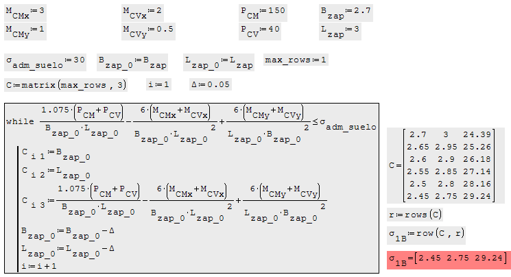

I am learning how to use Smath Studio, I want to write an iteration where an increment of 0.5 is added to two declared variables "a" and "b" which are replaced in a formula and it gives me a final value "X" and the condition is that the iteration stops when the final value is equal to or less than a declared value "Y" to finally extract from the iteration array the row with the three values that meet this condition: [a b X]

This is the structure that I have been writing to iterate but I need to extract the row of interest, which in this example has to be less than or equal to sigma_adm_suelo, this row is the last
matrix_programming.sm (13,71 КиБ) скачан 817 раз(а).

I already resolved it
matrix_programming.sm (13,31 КиБ) скачан 815 раз(а).

Greetings,
You may want to consider the use of a for loop instead of a while statement:
Copy and Paste the following into your worksheet:
line(#,for(i:1,i<10,i:i+1,line(#,#,#,#,4,1)),#,3,1)
May this be of Good Help;
⚜ Kenny Lemens, P.E. ᵂᴵ

The result I am looking for is that it meets the initial condition, how would I stop at the iteration that meets this condition, to be able to do it using the "for" command that you suggested and not the 10 iterations that I declare for "i"
matrix_programming_for.sm (16,08 КиБ) скачан 889 раз(а).

Hola Orlando. You can use break inside the for loop.
matrix_programming_for.sm (17,19 КиБ) скачан 832 раз(а).

The 'i < 10' statement would be replaced with your criteria (ie., ≤ σ.adm_suelo). Regardless, the largest issue you have is with regards to how SMath programs; you need to follow the 'rules' of setting up programming functions within a line() group, where the last item is the value returned as a result.
Copy and paste the following into your worksheet:
C.summary:+line(C:matrix(max_rows:1,3),for(i:1,({1.075*(P.CM+P.CV)}/{B.zap_0*L.zap_0}-{6*(M.CMx+M.CVx)}/{B.zap_0*L.zap_0^2}+{6*(M.CMy+M.CVy)}/{L.zap_0*B.zap_0^2}≤σ.adm_suelo),i:i+1,line(el(C,i,1):B.zap_0,el(C,i,2):L.zap_0,el(C,i,3):{1.075*(P.CM+P.CV)}/{B.zap_0*L.zap_0}-{6*(M.CMx+M.CVx)}/{B.zap_0*L.zap_0^2}+{6*(M.CMy+M.CVy)}/{L.zap_0*B.zap_0^2},B.zap_0:B.zap_0-Δ,L.zap_0:L.zap_0-Δ,5,1)),C,3,1)
The matrix produced by C.Summary should be what you are after (I simplified the equ by removing Maxima() function calls)

Maxima is not popular in the Smath Community users.
Don't even recall a single of those decoration gyzmas.
matrix_programming (1) Ignore Maxima.sm (14,09 КиБ) скачан 857 раз(а).
