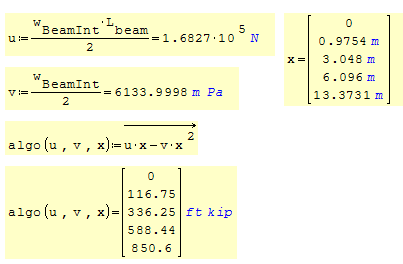

#1 Posted: 8/18/2022 3:53:39 AM
John Bhang
John Bhang
0 likes in 1 posts.
File not found.File not found.File not found.

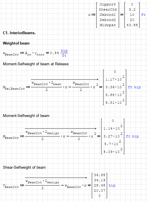

I can not have a right calculation results though I tried to resolve this several times.
When I am using the matrix format, I get the wrong results.
In case that I am using the simple format x=20ft, I get the right result.
Please help me out.
#2 Posted: 8/20/2022 9:45:47 PM
598 likes in 1,380 posts.
Since x is a matrix and you are using it with other variables, you have to use vectorize.
You can either write it as a function or click to its button on toolbar > matrices.
#3 Posted: 8/21/2022 8:34:59 PM
You can make each demand algo style
1rst demand exemplified.
The algo style will support in-situ infinite command line.
... in-situ infinite command line wrt [u,v,x]
A damned elegant Pro. style project !
#4 Posted: 8/22/2022 9:12:54 AM
Here is your file fixed.
2 psc beam bridge(US unit)-Dead Load_fixed.sm (188.45 KiB) downloaded 1287 time(s).
