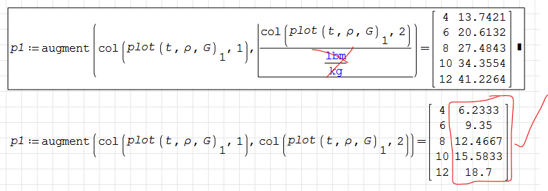

Trying to take Ber7's help a little further.
Is there a way to "functionalize" the loop? I'm having an issue with UNITS (required). Not possible, because of units, is an acceptable answer.Heat Capacity Function.sm (28.72 KiB) downloaded 1087 time(s).

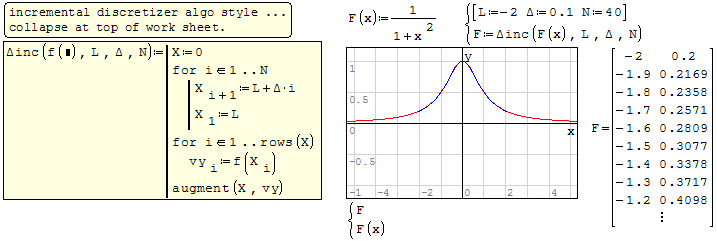

Just opened Ber7 document and completed to export the multiple data sets.
You can tabulate as well p2, p3, ... p6 then make a unique export table.
The meshed pivot is an exceptional tool, save it.

... super discretizer, algo style.

You need to delete the units in the your version as BER7 had accounted for it in the function ... I know you hate units. I need to digest your follwup posted sheet

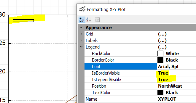

Really helpful. Is there a reason that a legend cannot be created on the plots (X-Y Plot) that are individual colors? I realize you used the built in graph and I updated my snippet sheet with the X-Y PlotCapture.PNG
NEVERMIND ... It'S under TRACES, not LEGEND

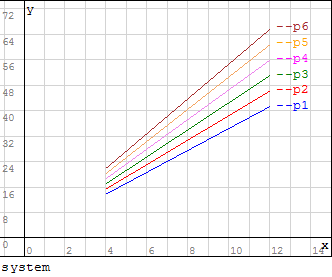

X_Y plot does not recognize the multiple linterp, thus plots one trace only.
Alternately, you can add some sort of legend on the QuickPlot.
Page8 Elsid.sm (60.17 KiB) downloaded 1253 time(s).

Graph with legend

Thank you guys. I should have just deleted the question when I figured out the legend issue in lieu of answering myself. As mentioned above, it was under TRACES, not LEGEND, in the X-Y Plot

This is my current hang up with the units
