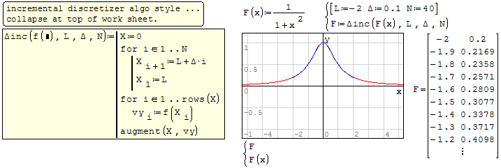

#8 Опубликовано: 19.01.2021 02:24:08
Fridel Selitsky
Fridel Selitsky
Graph of a function with dimensionless arguments
Plot.sm (7,33 КиБ) скачан 1084 раз(а).

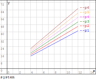

#10 Опубликовано: 19.01.2021 15:05:57
Re-uploaded file without a closed area to see if this helps Jean
Just opened Ber7 document and completed to export the multiple data sets.
You can tabulate as well p2, p3, ... p6 then make a unique export table.
The meshed pivot is an exceptional tool, save it.
Plot Otherwise SS6179.sm (35,29 КиБ) скачан 1091 раз(а).

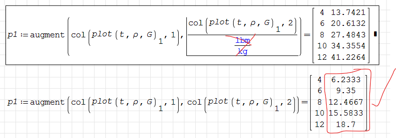

#11 Опубликовано: 19.01.2021 17:01:14
... super discretizer, algo style.
#12 Опубликовано: 19.01.2021 21:08:42
Ruben Sidranski
Ruben Sidranski
You need to delete the units in the your version as BER7 had accounted for it in the function ... I know you hate units. I need to digest your follwup posted sheet
#13 Опубликовано: 20.01.2021 11:49:12
You can have it otherwise as well.
Page8 Elsid.sm (59,07 КиБ) скачан 1226 раз(а).

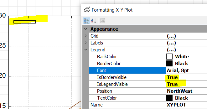

#14 Опубликовано: 20.01.2021 16:01:51
Ruben Sidranski
Ruben Sidranski
Thank you Jean,
Really helpful. Is there a reason that a legend cannot be created on the plots (X-Y Plot) that are individual colors? I realize you used the built in graph and I updated my snippet sheet with the X-Y PlotCapture.PNG
NEVERMIND ... It'S under TRACES, not LEGEND
#15 Опубликовано: 20.01.2021 18:08:02
Thank you Jean,
X_Y plot does not recognize the multiple linterp, thus plots one trace only.
Alternately, you can add some sort of legend on the QuickPlot.
Page8 Elsid.sm (60,17 КиБ) скачан 1253 раз(а).
#16 Опубликовано: 20.01.2021 20:36:22
Ruben Sidranski
Ruben Sidranski
Thank you Jean and Ber7.
This has turned into a rabbit hole to document (notes) how to plot an equation with two range variables with a function. Is there a way to eliminate #X1 (t1 in this example)? In short, is there a function? or way to eliminate the units from #X (t in this example). Heat Capacity Function1.sm (20,42 КиБ) скачан 1630 раз(а).
Didn't work how I wanted, but similar to dividing vectorized (t/Unitof(t)).

#19 Опубликовано: 21.01.2021 08:48:58
Fridel Selitsky
Fridel Selitsky
Graph with legend
Ps.sm (7,12 КиБ) скачан 1097 раз(а).
#20 Опубликовано: 21.01.2021 11:17:04
Ruben Sidranski
Ruben Sidranski
Thank you guys. I should have just deleted the question when I figured out the legend issue in lieu of answering myself. As mentioned above, it was under TRACES, not LEGEND, in the X-Y Plot
