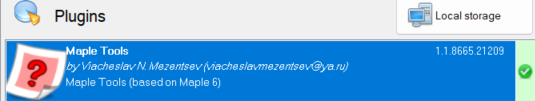

Is it not possible to use the latest version of Maple engine or at least a newer one?
I see that currently version 6 of Maple (released in year 20000, so 24/25 years ago) is used:
I am wondering if is not possible to use a newer version of Maple engine in Smath?

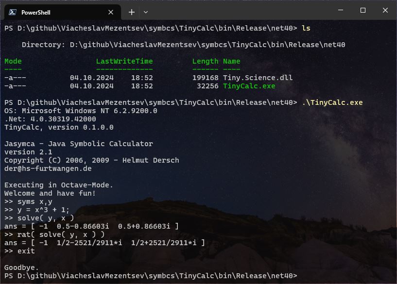

I have my own development for this case, if necessary, I can connect my own port for symbolic engine based on Jasymca.

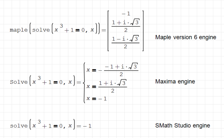

Oh, so we see that SMath own engine is very week...though the problems was pure numeric...
#12 Posted: 10/4/2024 9:39:50 PM
1,555 likes in 1,867 posts.
As for your example, you have to be honest. SMath Studio writes in the documentation what this function does. It is neither good nor bad. It does its job.
