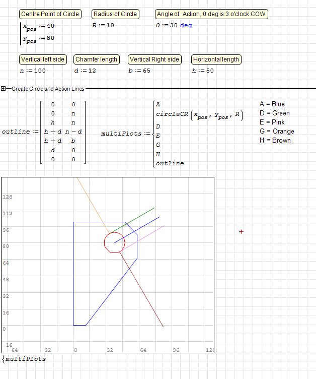

Hi All,
Trying to work out a universal way of getting the length of intersecting lines, easy when lines are level, but not so (for me) others.
The image below shows a lifting lug, the angle of action can be 0 deg to 150 deg for example. I need to know the length of the lines from the red circle to the outline, individually, then I can see the shortest length, this must be for all angles, effectively tracing the intersection point through the angles. I know I can use Pythagoras, but was hoping to use something like GPC, but this works only for polygons?
Lug Horizontal.sm (26.94 KiB) downloaded 693 time(s).

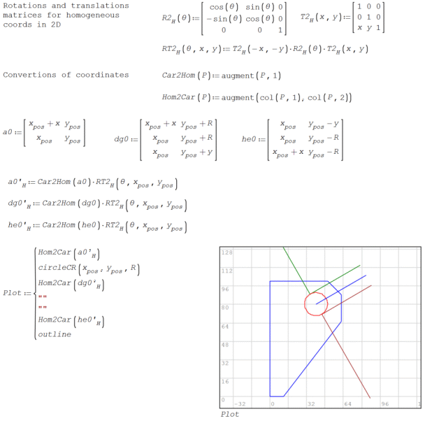

#5 Posted: 7/20/2020 5:24:38 AM
Fridel Selitsky
Fridel Selitsky
520 likes in 451 posts.
ianlh, in your example it’s convenient to use the rotation matrix
Lug Horizontal1.sm (18.13 KiB) downloaded 691 time(s).

#6 Posted: 7/20/2020 8:34:13 AM
Whereas the system is built scalar wrt θ
make it more convenient local at graph display.
Lug Horizontal_2.sm (22.51 KiB) downloaded 712 time(s).

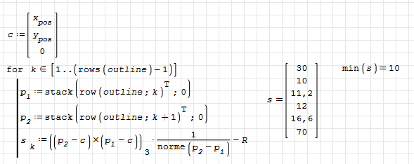

#7 Posted: 7/20/2020 1:46:20 PM
1,332 likes in 2,241 posts.
This provides the shortest distance from the segments of the polygon to the circle. However, the distance isn't really to the segment but to a line through the endpoints of the segment. There is no test if the normal to the line through c is between the vertices of the segment.
For the given geometry this works. For proof of strength this is only useful if a given force may act under any angle but the force doesn't depend on that angle.
Lug Horizontal_Kr.sm (31.23 KiB) downloaded 677 time(s).

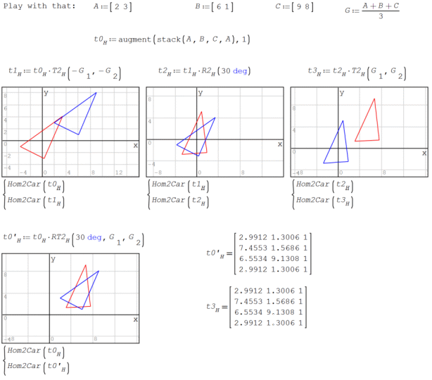

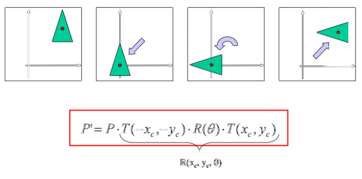

#9 Posted: 7/21/2020 2:44:11 AM
1,080 likes in 1,752 posts.
Hi. This is what's actually do the Ber'f function:
But notice that for use matrix multiplication for translations you must to use homogeneous coords ( http://elopez.fime.uanl.mx/@materias/732/@Tema%203%20-%20Transformaciones%202D.pdf page 15)
frapuano 7/21/2020 7:04:00 AM, Fridel Selitsky 7/21/2020 4:23:00 AM
#10 Posted: 7/21/2020 7:37:50 AM
Fridel Selitsky
Fridel Selitsky
Thank you, Razonar.Aapplying homogeneous coordinates helps automate the process.
Variant with homogeneous coordinates
Lug Horizontal3.sm (17.83 KiB) downloaded 718 time(s).
frapuano 7/21/2020 9:44:00 AM, Alvaro 7/21/2020 1:48:00 PM
#11 Posted: 7/21/2020 2:15:57 PM
Variant with homogeneous coordinates ...
Another variant.
Lug Horizontal4.sm (34.62 KiB) downloaded 714 time(s).

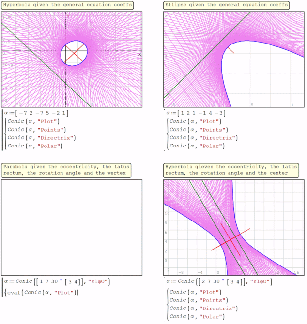

I try to modify for use that in https://en.smath.com/forum/yaf_postst17357_Conics.aspx but can't found a close end. This is my atemp for the dual of a conic, it's envelope:
Fridel Selitsky 7/21/2020 3:25:00 PM, frapuano 7/22/2020 8:29:00 AM

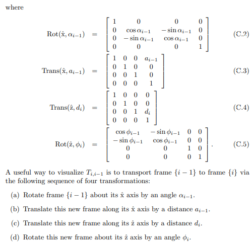

#13 Posted: 7/27/2020 12:37:33 AM

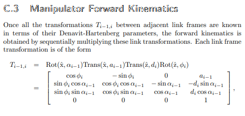

Hi Ber. That's not science, that's art. Maybe you can find this book interesting: Modern Robotics.
At page 608 in the pdf, for example:
The notation isn't the best, but it can be converted to a general Rotations and translations for the forward kinematics of a robot.
Fridel Selitsky 7/27/2020 4:49:00 AM, sergio 7/27/2020 4:57:00 AM
#14 Posted: 7/27/2020 5:31:15 AM
Fridel Selitsky
Fridel Selitsky
Hello Razonar. "Modern Robotics" book
sparked my big interest. Thank you for the link.
