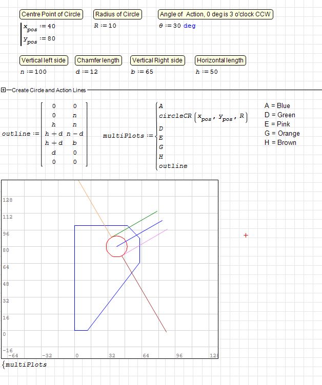

Hi All,
Trying to work out a universal way of getting the length of intersecting lines, easy when lines are level, but not so (for me) others.
The image below shows a lifting lug, the angle of action can be 0 deg to 150 deg for example. I need to know the length of the lines from the red circle to the outline, individually, then I can see the shortest length, this must be for all angles, effectively tracing the intersection point through the angles. I know I can use Pythagoras, but was hoping to use something like GPC, but this works only for polygons?

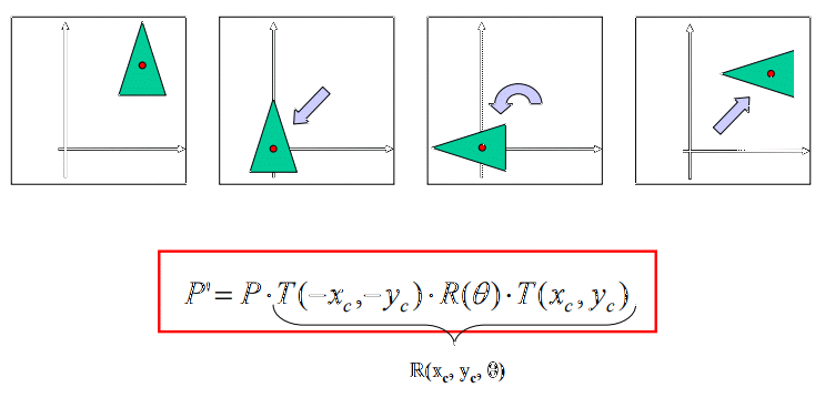

ianlh, in your example it’s convenient to use the rotation matrix
Lug Horizontal1.sm (18,13 КиБ) скачан 1108 раз(а).

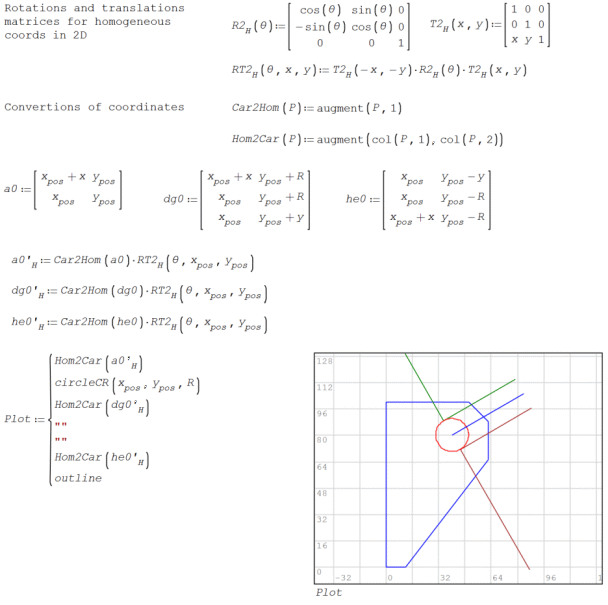

Hi. This is what's actually do the Ber'f function:
But notice that for use matrix multiplication for translations you must to use homogeneous coords ( http://elopez.fime.uanl.mx/@materias/732/@Tema%203%20-%20Transformaciones%202D.pdf page 15)

Thank you, Razonar.Aapplying homogeneous coordinates helps automate the process.
Variant with homogeneous coordinates
Lug Horizontal3.sm (17,83 КиБ) скачан 1128 раз(а).

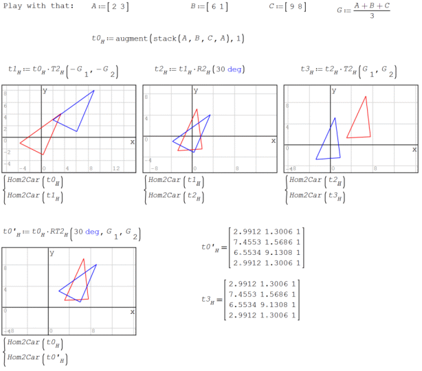

#11 Опубликовано: 21.07.2020 14:15:57
Variant with homogeneous coordinates ...
Another variant.
Lug Horizontal4.sm (34,62 КиБ) скачан 1134 раз(а).

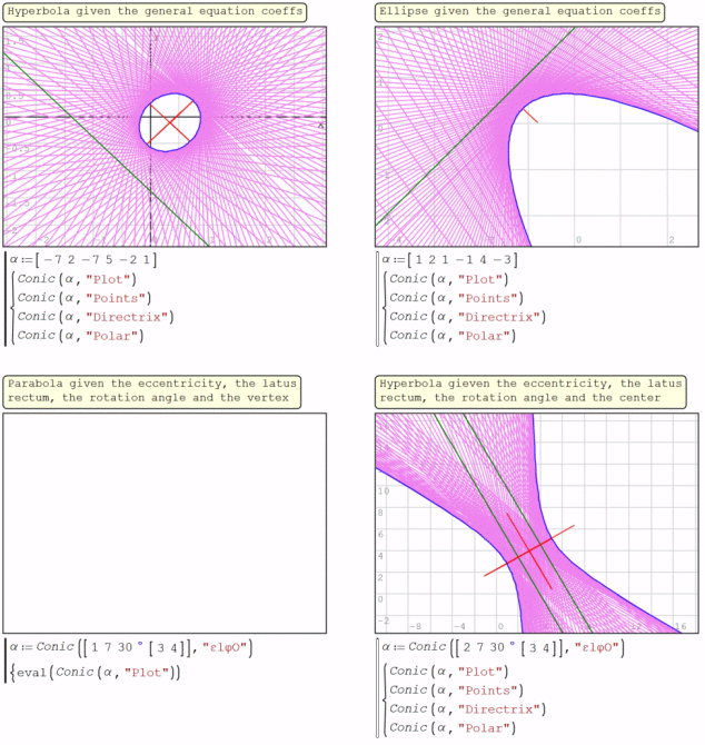

Homogeneous coordinates are helpful in projective geometry and conics and quadrics. For instance, preserve the duality, because you can use line coordinates ( https://en.wikipedia.org/wiki/Line_coordinates ).
I try to modify for use that in https://en.smath.com/forum/yaf_postst17357_Conics.aspx but can't found a close end. This is my atemp for the dual of a conic, it's envelope:
Fridel Selitsky 21.07.2020 15:25:00, frapuano 22.07.2020 08:29:00
