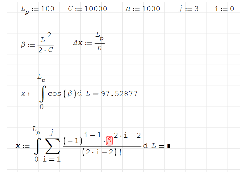

Why "beta" works in Cos(), while it doesn't in the second integration?

Seems it is an error in combination of int() and sum() functions. Will check this.

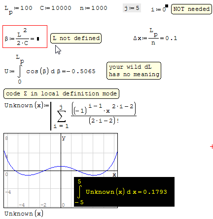

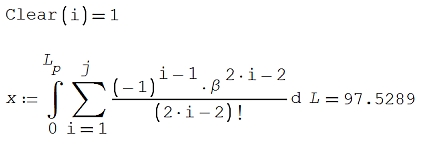

Maybe like this.

Hi. You define "i:0" at top right. Sum() index is not local and take that value. You must to clean i or use another letter.
