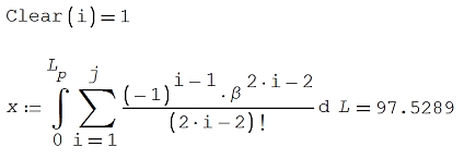

Why "beta" works in Cos(), while it doesn't in the second integration?
1.sm (6,15 КиБ) скачан 807 раз(а).

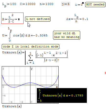

Maybe like this.

Hi. You define "i:0" at top right. Sum() index is not local and take that value. You must to clean i or use another letter.
sergio 09.01.2021 12:01:00
