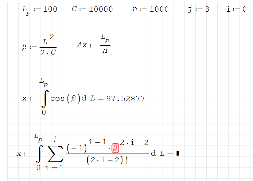

Why "beta" works in Cos(), while it doesn't in the second integration?

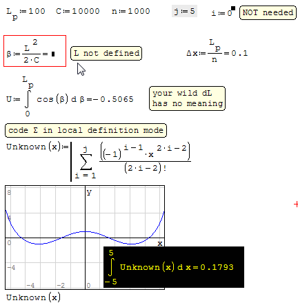

Maybe like this.

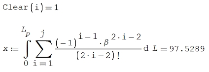

Hi. You define "i:0" at top right. Sum() index is not local and take that value. You must to clean i or use another letter.
