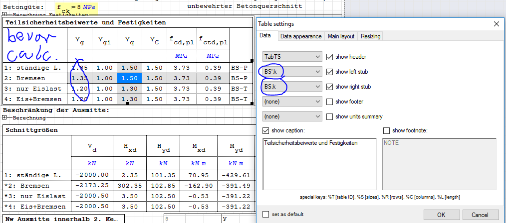

uncblue
2 likes in 18 posts.
Wow I had no idea this plugin even existed.
Thanks so much to the SMath contributors and especially Davide for this plugin.
#48 Posted: 7/5/2017 2:57:31 PM
127 likes in 342 posts.
Ok works as well as before

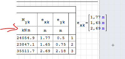

#49 Posted: 7/5/2017 6:17:14 PM
uncblue
uncblue

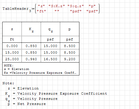

Davide,
I looked through the example files but I didn't see anything that addressed my situation.
I'm not sure if this is even possible or if I overlooked the option.
Is there a way to word wrap the header to fit a set width for the numeric table values?
The second table in the screenshot is similar to what I'm trying to achieve.
I also made a quick example in excel to help illustrate.
I was also going to use the footnote option as an alternative but I'm came across a similar problem where I couldn't widen the note section since it appears dependent on the table width.

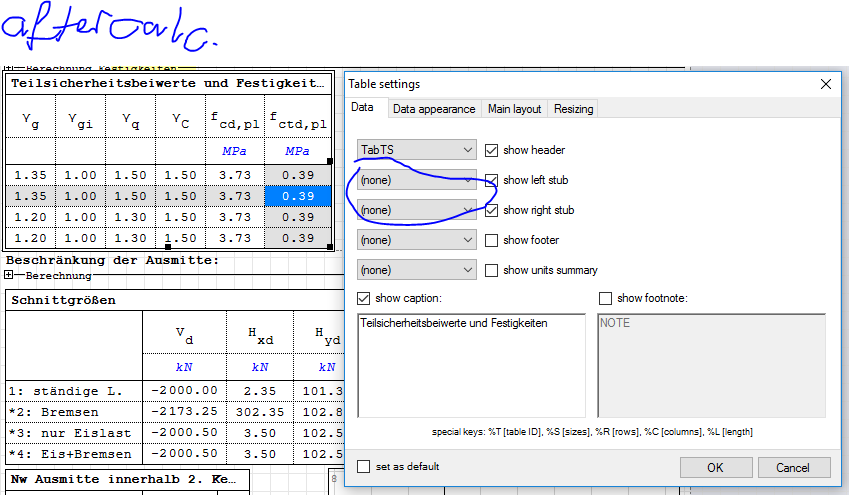

found an issue in Version 0.1.6395.15149, using SMath 0.98.64.84.
It is related to using commas (,) for decimal separator.
The plugin seems to replace every point with a comma, also where used as subsript.
e. g. "BS,k" (the string "BS,k" cannot be found in the sm-File).
Tables work well if point as decimal separator is used.
Bevor calculation:
After calculation:

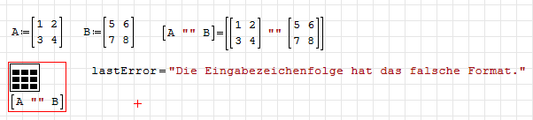

Nested arrays as input for a table don't work anymore, too.

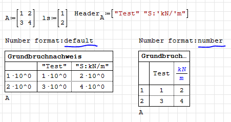

#56 Posted: 10/9/2017 2:58:20 AM
Martin_B
Martin_B
22 likes in 84 posts.
Thanks for your improvement, Davide.
In following screenshot you can see the following behaviour:
With number format set to default...
- numbers are always written with exponent (left/right stub also)
- strings are printed with surrounding "" and Expressions are not formatted
By changing the number format to number, everything looks as usual.
Is that intended?
Davide Carpi 10/9/2017 4:14:00 AM
#57 Posted: 10/9/2017 4:27:01 AM
